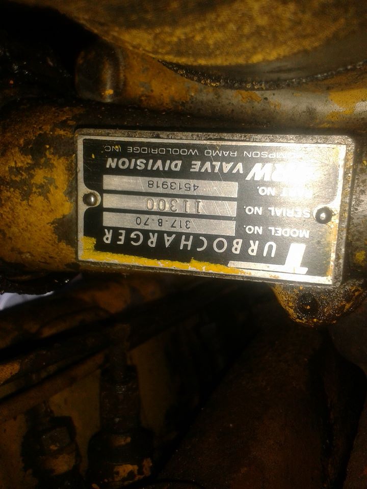

Brake fluid finally dissolved the paint on the tag. No one seems to be able to cross:
Air Research T0448 P/N 408270-3 Allis p/n (7)4023985

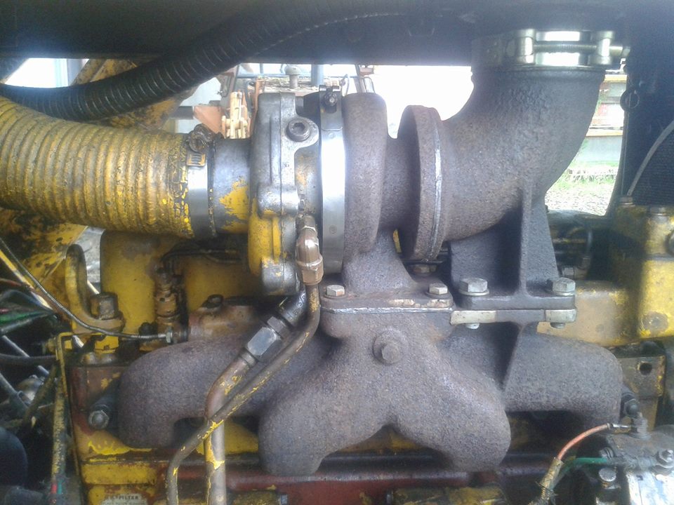

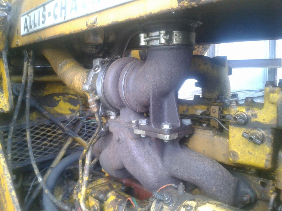

hello dave if these are any help to you this is my allis chalmers HD7G S/N 23020  I think its year 62/64 not sure maybe you can correct this for me ?
Points: 35650
Post Options Post Options   Thanks (0) Thanks(0)   Quote DMiller Quote  Post ReplyReply Direct Link To This Post Posted: 09 Oct 2017 at 5:13pm
That is what mine is supposed to look like! Mine is one of the last 74-76 but has the same aspirator design on the square air cleaner at the operator station. All but eliminated on mine as well. Currently no one responding to parts requests on the exhaust in the states. Hector has parts off a G-B but won't cross to mine. Thanks Dave.
