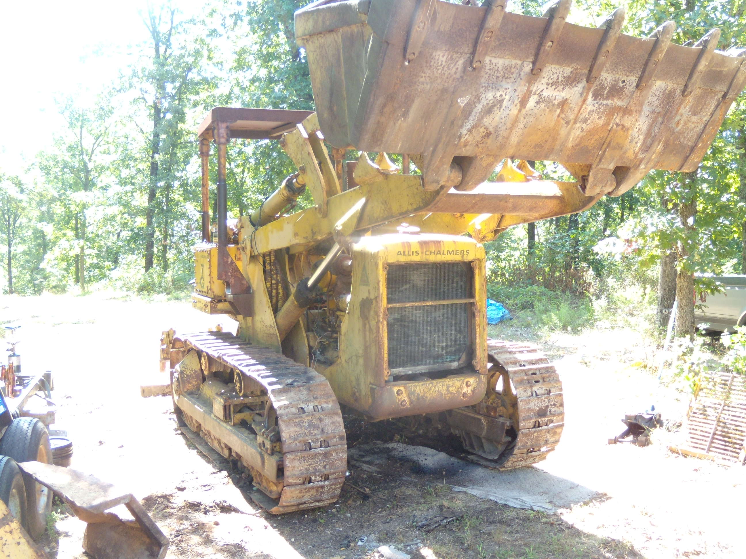

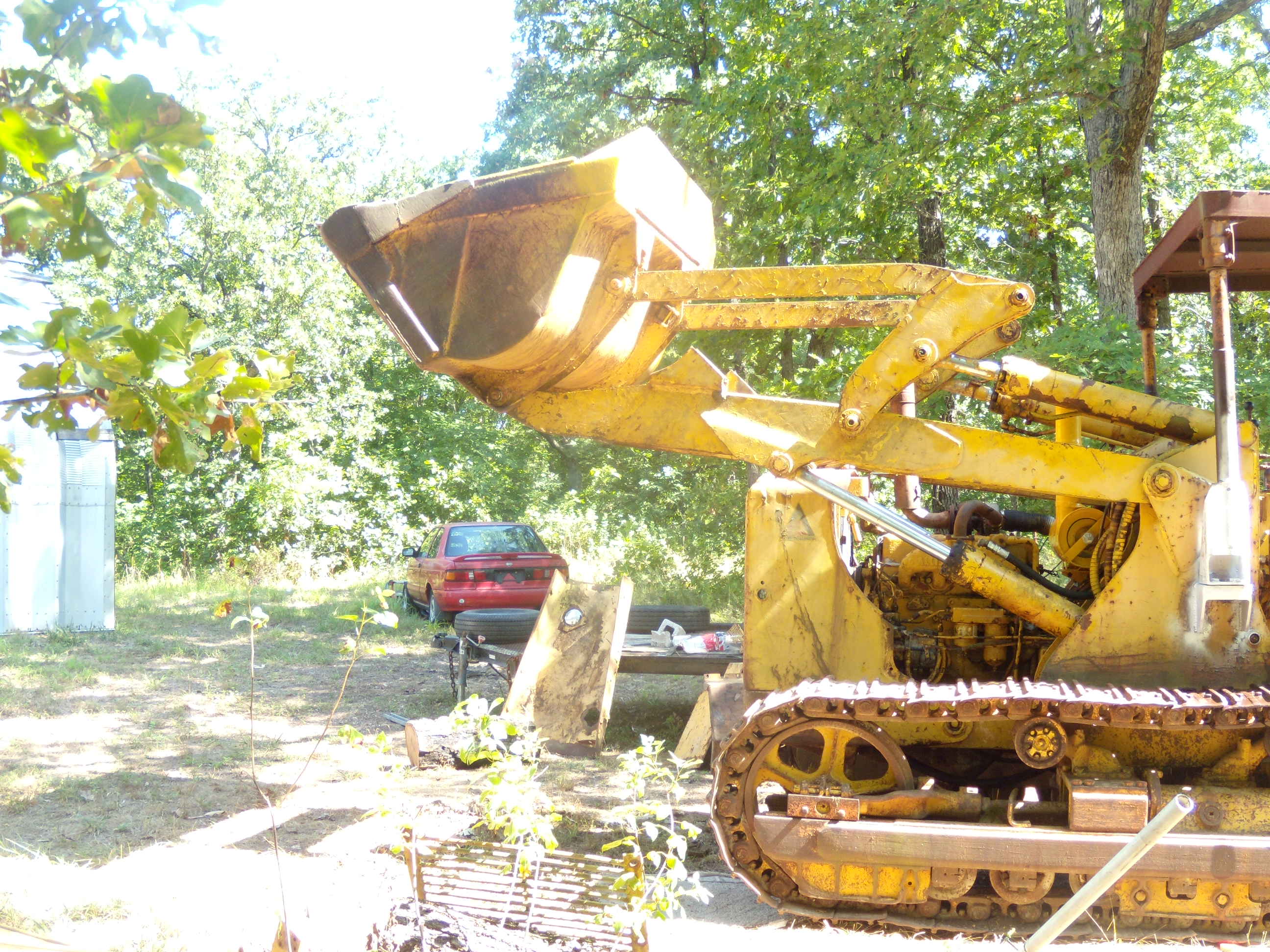

Post Options Post Options   Thanks (0) Thanks(0)   Quote doctorcorey Quote  Post ReplyReply Direct Link To This Post Posted: 20 Oct 2011 at 9:10am
this is the best pic I can provide until monday. I'll get a close up on Sat. C.

Post Options Post Options   Thanks (0) Thanks(0)   Quote michale34 Quote  Post ReplyReply Direct Link To This Post Posted: 20 Oct 2011 at 9:45am
i do remember seeing a 7g one time with the throttle leaver in the floor instead of on the dash and by just getting a glempse of this machine it looks like the bucket controles are like the  6g

Post Options Post Options   Thanks (0) Thanks(0)   Quote Dozer Quote  Post ReplyReply Direct Link To This Post Posted: 20 Oct 2011 at 5:30pm
Thank you for the picture. I find it interesting that your HD7 is different than mine. My s/n is HD7G 23776. Is yours newer or older than mine?
doctorcorey View Drop Down
Joined: 17 Jul 2011
Location: S. KC Missouri
Points: 589
Post Options Post Options   Thanks (0) Thanks(0)   Quote doctorcorey Quote  Post ReplyReply Direct Link To This Post Posted: 20 Oct 2011 at 5:53pm
  Mine, I think was made in 1961. I'll check the number tonight and let you know the number. I can tell there was some mod made to the throttle linkage. They eliminated the speed governor linkage from the tranny. I have a  lever throttle at my left foot. I'll say one thing, they built every part of these machines out of plenty of iron.

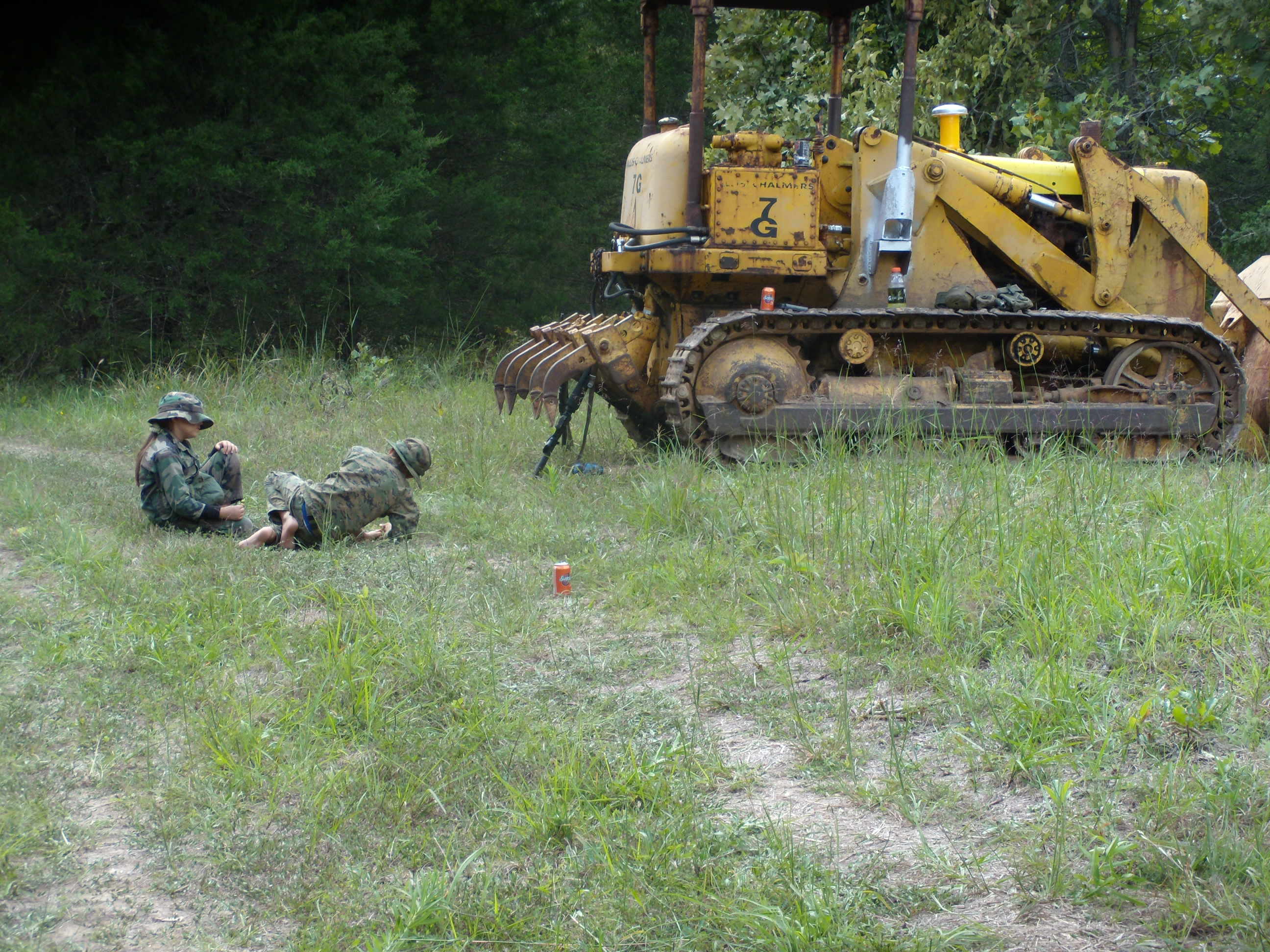

I didn't know I already had this picture:
michale34 View Drop Down
Joined: 15 Mar 2011
Location: arkansas
Points: 472
Post Options Post Options   Thanks (0) Thanks(0)   Quote michale34 Quote  Post ReplyReply Direct Link To This Post Posted: 24 Oct 2011 at 3:37pm
ok it looks like the air breather was in the das and was taken out and replaced by the round one
