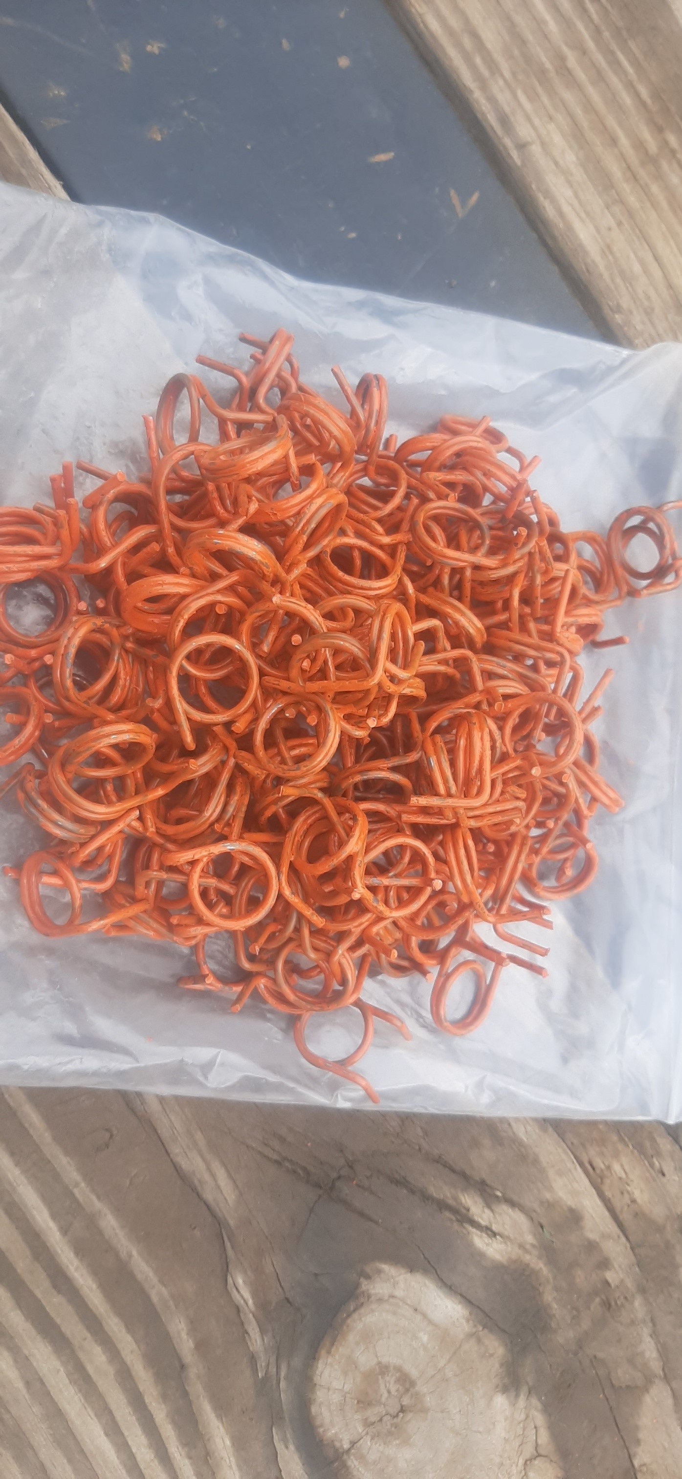

Anyone had the mechanisms inside the hub apart? My basket stops turning and I’m under the impression the springs that hold the dogs into the outer hub must be worn out. Anyone have any NOS parts? Thanks in advance.

I had mine apart on all my rakes. Really simple and easy to fix. Agco had the spring a year or so ago. Look at the pins too. They bend occasionally. Albert at Ziegler cat in maryville mo can help you out

 Wade...I have springs.....DALE
