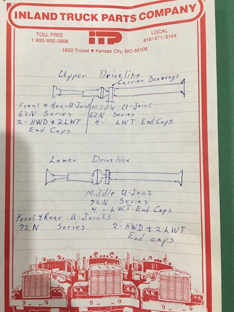

Most of the 7580/8550's around here locally had both drive shafts converted to the two piece hanger bearing style. I over greased both of the shafts on my 8550 but over time the slip yoke splines did wear. One important thing to note is that the two piece style runs a lot smoother and is less apt to affect the pto drop box bearings. I have the parts list somewhere if anyone is interested. , Mike

They were advertised in the back pages of farm magazines. A-C did not design or promote it. When the 4W series came out, someone made their own version of that design. At the time parts for the driveline from A-C were very high and I suspect this also drove the need for a new design, with off the self components. The thing to remember though is on the 4W series the pto driveline turns considerably slower than the 75/85 series tractors. You will still get some vibration during full left or right turns but pulling "straight" the shaft runs true and no vibration. I have the handwritten parts list that I used to fabricate mine. I will try to post it sometime. , Mike

Here is the parts list from Mike Kroupa.
Steve
