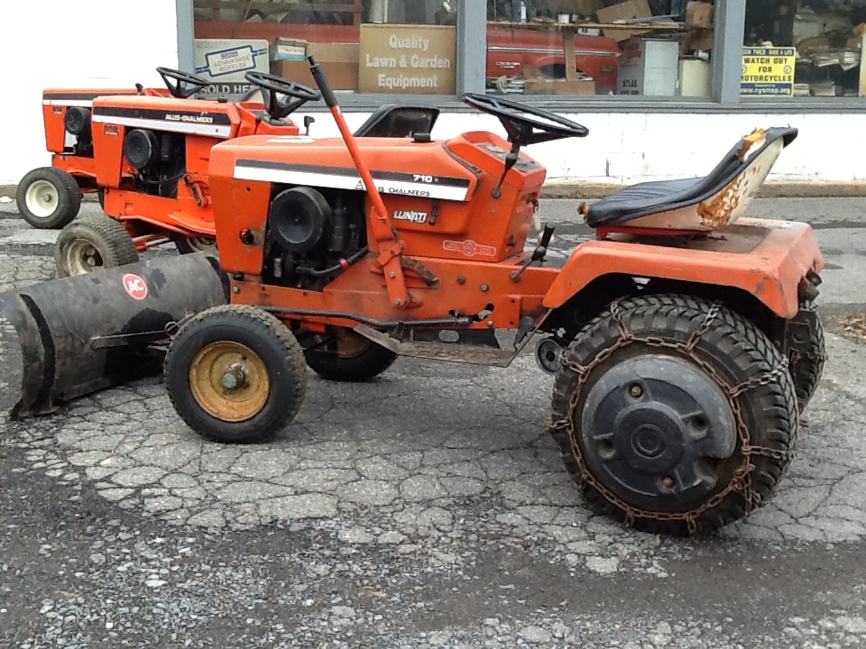

Yea the clutch in the middle goes down to the deck, and you can also run belt under seat to back and run anything back there like tiller leaf vacuum and other stuff. The 900s ran the blower down under like the deck just all the way up to the front.
That's awesome you got it running already.
Here's a picture of our two 710
Edited by Mikez - 28 Oct 2018 at 10:01pm

Ok! Yeah, I'm happy with it. Will be a fun little tractor. Those look pretty nice! I will have to post a pic of mine.
