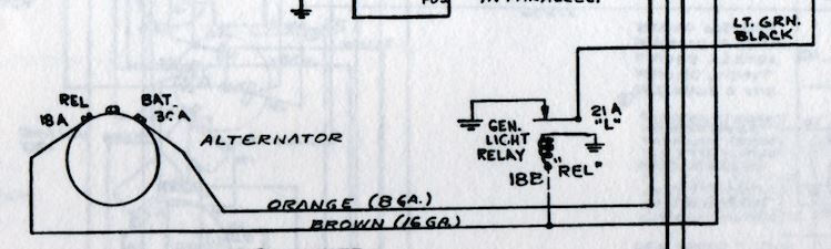

sounds like you got it figured out now.. I thought you were using ONE wire.. As long as you have TWO wires, its fine.. I have no idea why you have a third wire (brown) available.. It should look something like this below..  As mentioned, the #2 spade is always HOT, and normally comes from the  HOT wire on the key switch.. Some "aftrmarket" installs just jump to the BIG LUG for the power....... The #1 spade is excitation and can have a light bulb or a resistor in the line, and gets power ONLY when the switch is ON.
BASIC DRAWING..

Post Options Post Options   Thanks (0) Thanks(0)   Quote steve(ill) Quote  Post ReplyReply Direct Link To This Post Posted: 28 Sep 2023 at 8:42am
saw this on the internet on a 7060... THey have a RELAY in the green wire / brown wire that cuts IN and OUT depending on where the power is coming from...it appears the LIGHT is GROUNDED thru the RELAY and not the Alternator #1 terminal..
Possibly your RELAY is burn out, or has by bypassed ??
Either way, your in good shape now !
Edited by steve(ill) - 28 Sep 2023 at 8:49am
I’ll upload a photo from my book, because it has different Alternator options. That one you posted might be the Niehoff alternator some of them had?

Post Options Post Options   Thanks (0) Thanks(0)   Quote Lynn Marshall Quote  Post ReplyReply Direct Link To This Post Posted: 28 Sep 2023 at 8:55am
Those last schematics with the relay are for the early style neihoff.
