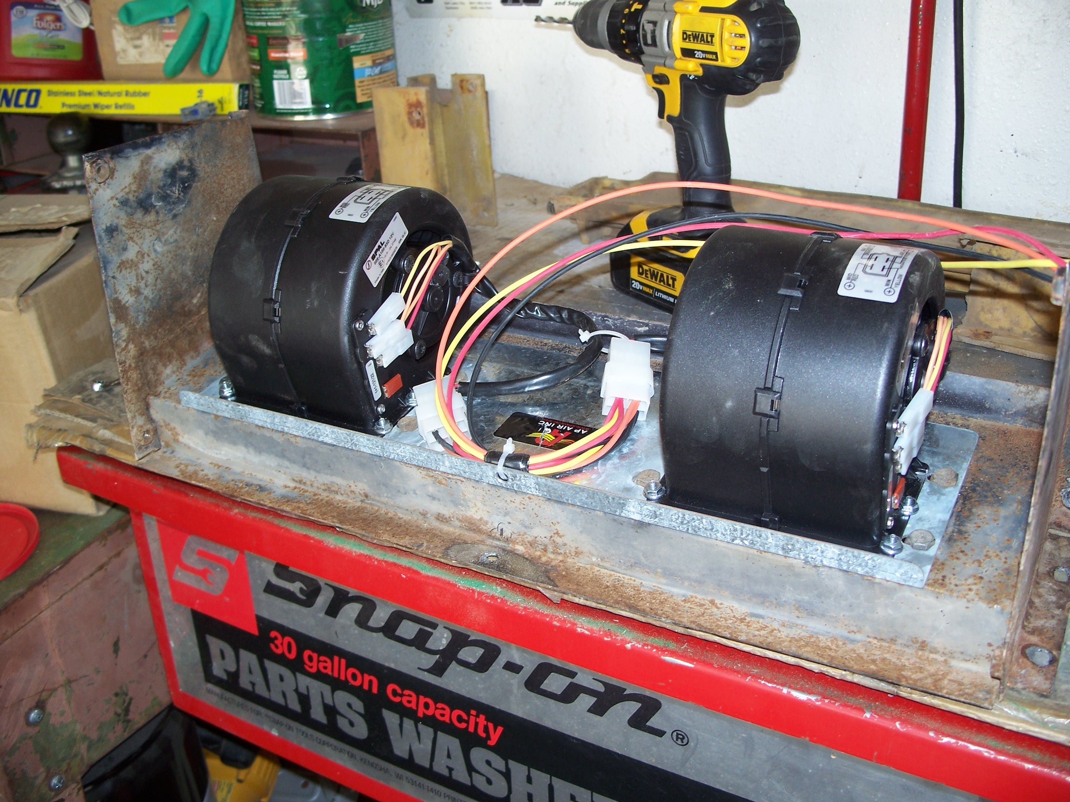

Couple of years ago I bought a hose kit and the cab fan from AP air.  The hoses fit perfect and this new fan is great, really quiet and moves a lot of air.  I would definitely buy that fan again.
