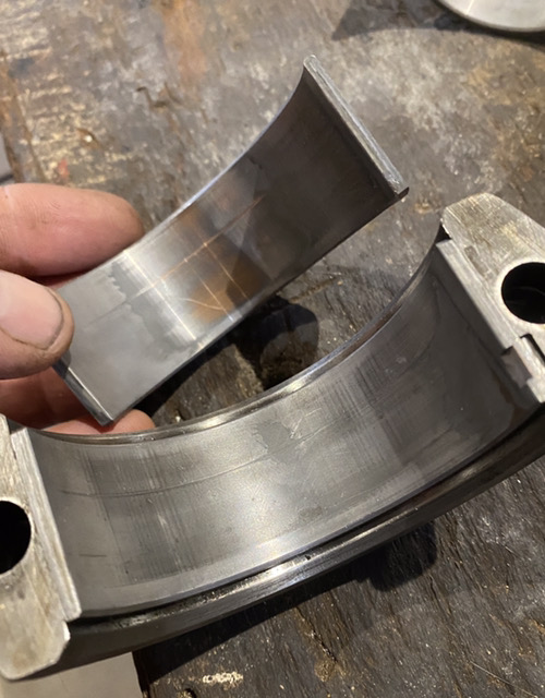

Bearing change on 7060 approx 12000 hrs,alot better then i thought they would be. We have owned this one since new so first time the oil pan has been off. Bearing date 76.

That's excellent for 12000 hours. Obviously you didn't tear it down just to look at them. What's the "rest of the story?"

At those hours it would seem that it didn't do alot of hard work. That's a 6000 hr looking bearing.

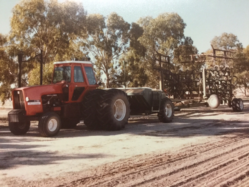

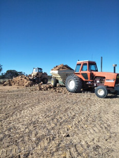

Yes i did just drop the pan for this,thought they were overdue and worried about the crank.Not touching the liners or rings as it doesnt have blowby or use oil.The first 6000+hours of this were worked very hard.24.5 x32 duals and wieghts pulling 32 ft air drill. The last half of these hours is now on single rears just pulling a spreader and other light loads.
