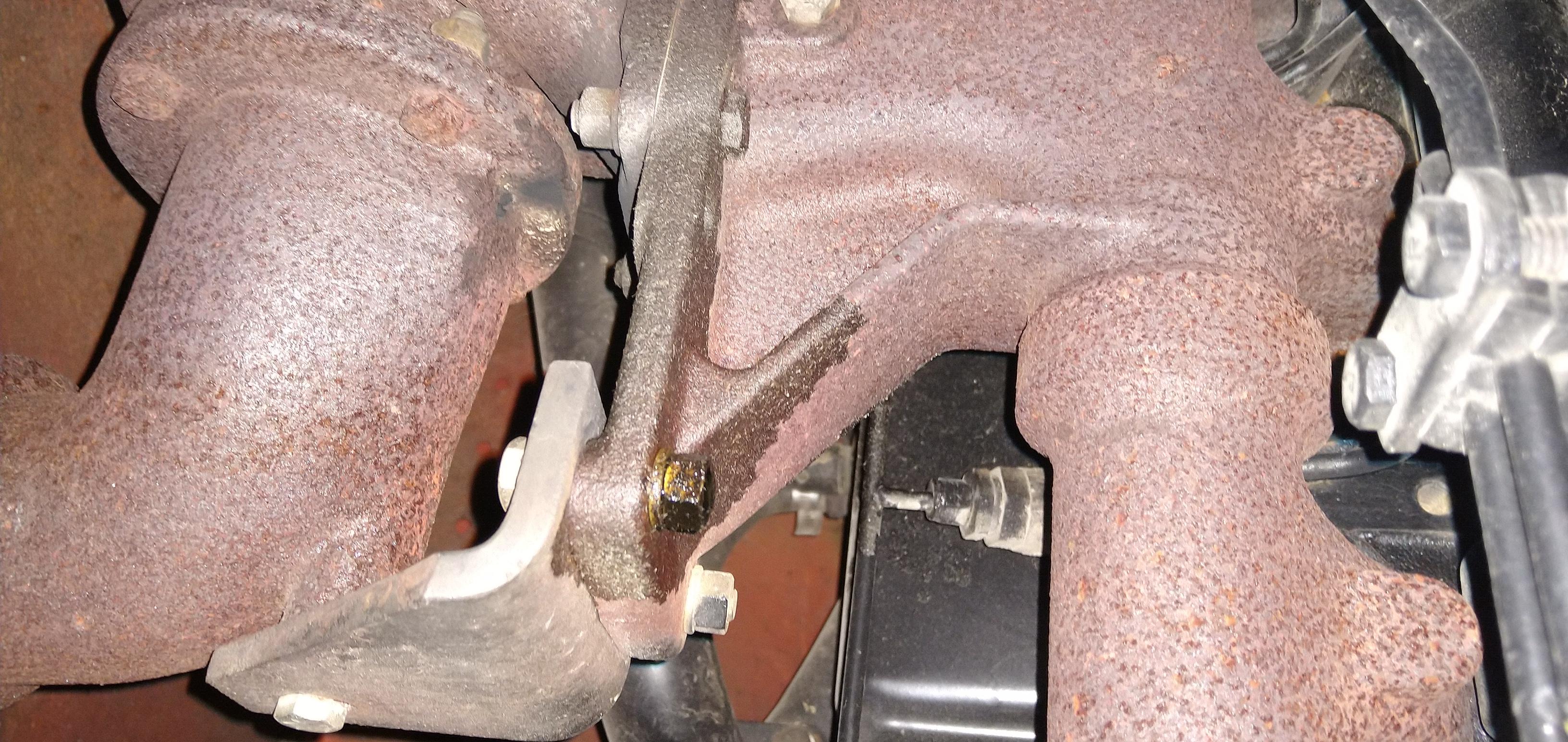

This morning I found that oil or maybe fuel had been leaking on the right side frame rail of the 7060. It appears to be coming from a bolt that connects exhaust pieces together near the turbo. It is not coming from above. What is going on here, please? Thank you.
I'm sorry the picture is huge, I tried to size it before upload but no luck.

Many diesels will “slobber” when idled for prolonged periods. Especially when they have high hours or miles… it’s normal, really. It will show up at exhaust manifold joints, turbo clamps, etc. it looks like theres a trail leading to that bolt that it’s dripping off of, but we can’t see the origin. Try bumping your engine speed up to 1000 rpm or so, next time you idle for an extended period, and see if it improves. Does the engine have much blowby? … if it originated on the cold side of the turbo, you may have more to worry about…

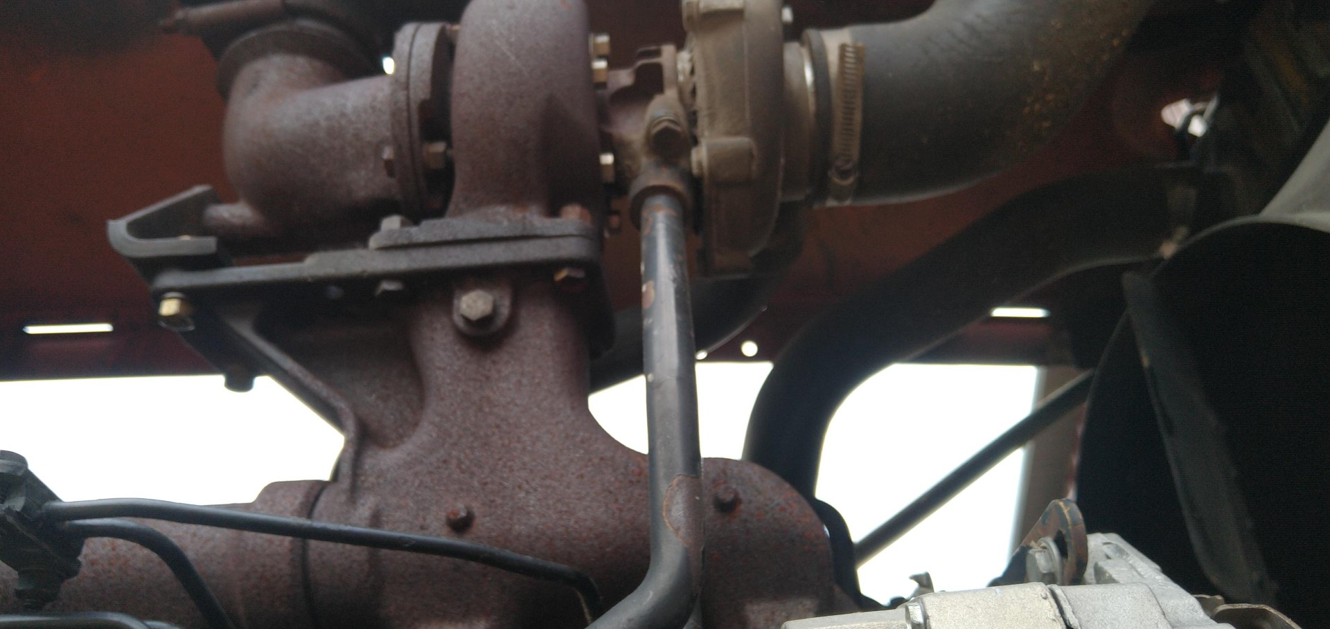

May be your turbo oil feed or drain tube are starting to leak and running back to that bolt and collecting there. Check closer, or post a pic of the whole area, it looks to me like it started farther forward and ran back.

I will get another picture in a bit. The top end of the engine was rebuilt about 300 hours ago.

The breather tube is basically dry. I always set the idle at 1100 per the engine guy that did the rebuild. I see where it could be coming from farther forward, I suppose the oil does weird stuff when it's hot. I will monitor it today when using it to pull wagons and see what happens.

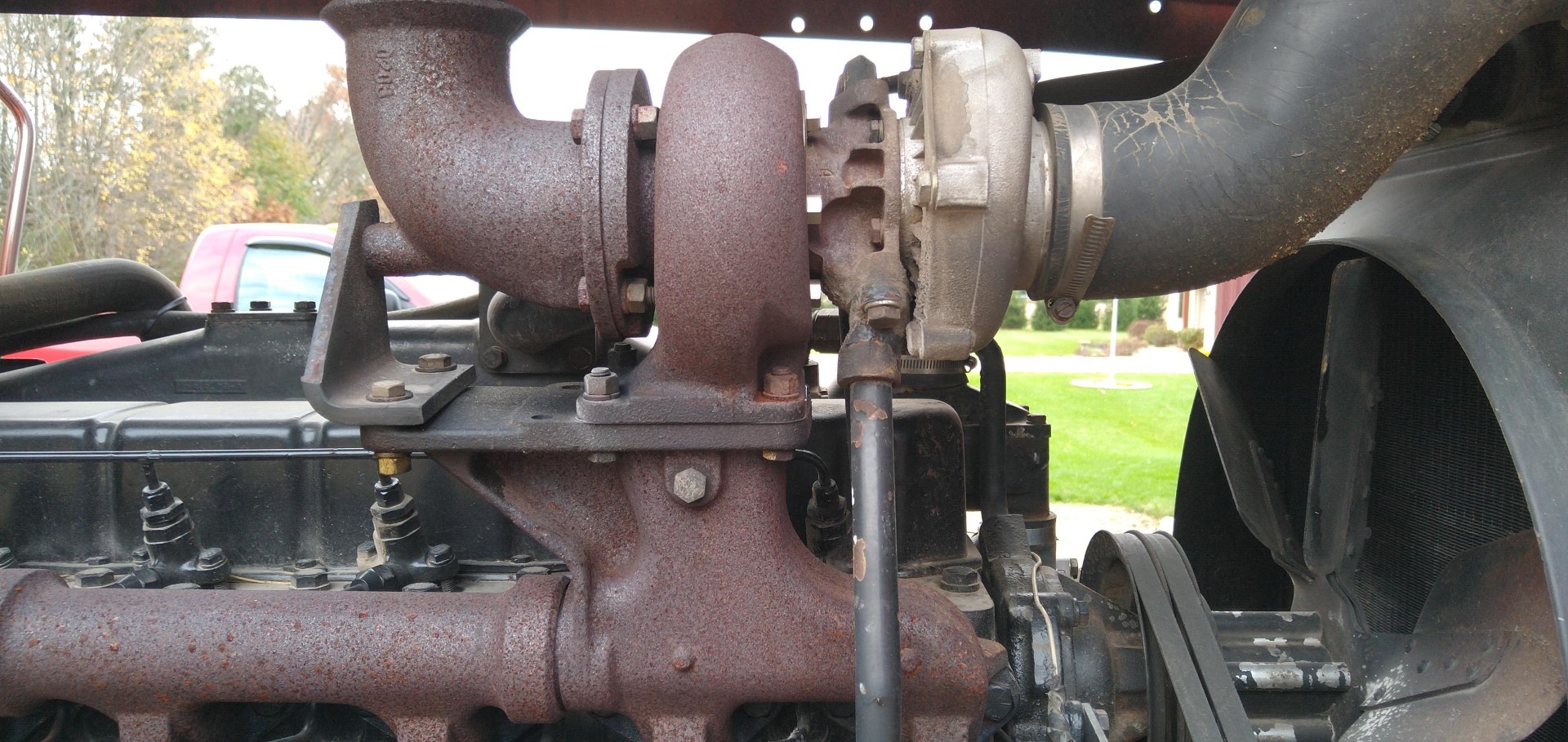

Well, looks pretty dry around the turbo… does appear that exhaust is leaking around turbo mounting flange gasket… on left side in picture. maybe the slobber was coming from same place and running down from there. When a big engine like that idles, and cools down from normal operating temperature, sometimes they slobber. Heat and cylinder pressure, boost, etc will facilitate better ring sealing while the engine is working hard. I would check that turbo gasket and mounting hardware, repair as needed. Make sure your thermostat isn’t stuck open, allowing lower than normal coolant temps, and bump your rpms up when idling. Wouldn’t worry much about it unless you’re starting to use more oil. Did you have the pump and injectors freshened up at time of overhaul?

I will have the mechanic check that out next time he's here. The pump and injectors were gone through at the time of the rebuild. I really appreciate your time and help. Thank you so much!
Edit to add: I will monitor the water temp to see if it runs differently than expected. I'm going with the slobber theory! Thanks again.
