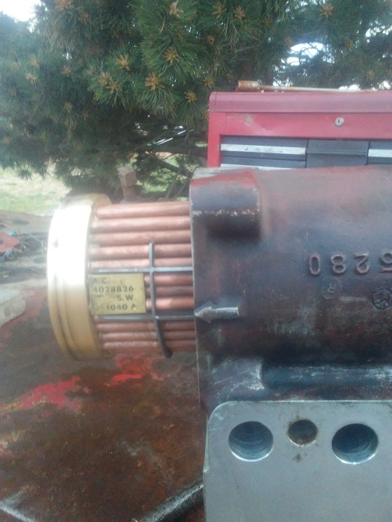

I got the oil cooler off, and apart late this afternoon. the O-rings that were in it looked to be a 'square' type on the oil side and an orange/red color on the coolant side, now, the new ones I got from AGCO are both black and  'round' style with different part numbers.
The big question is will these work? or is there a serial number break where a change was made? need to get this back together soon...

this is how it came apart,, so I'm putting it back together this way, arrows the same way..

I think your square ones were round new. Hopefully they are marked/seperated by pt# and you can look at agcopartsbooks.com and determine which one goes where.

70933325 lube oil side
70923637 water side

Steve, them are the part numbers that I have. I will use them,

Don't get your thinking backwards on oil and water

yep,, oil is on the inside, water to the outside..Hope to get it back together before the weekend, I got wheat hay I need to get cut down..

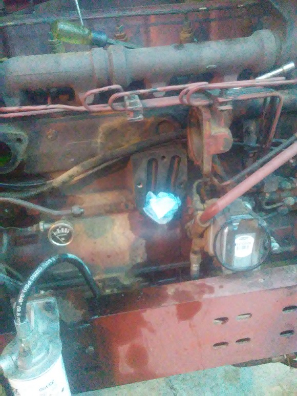

Michael V (NM), Good repair pictures - thanks for posting. With the cooler housing off for repairs, now would be a great time to paint maroon on engine block behind cooler & backside of cooler, in the normally hard to reach places.

Post Options Post Options   Thanks (0) Thanks(0)   Quote Michael V (NM) Quote  Post ReplyReply Direct Link To This Post Posted: 12 May 2018 at 10:07am
its back to work already
