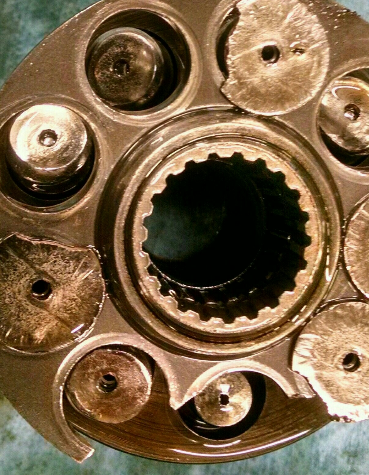

Found the problem. What is out there for piston pumps?
Destoke piston end hammered out and then threw metal in and tore out rotation group. What are the odds it hurt duel pump? _20160402_075125.JPG
Edited by Helland - 02 Apr 2016 at 7:52am

Post Options Post Options   Thanks (0) Thanks(0)   Quote SHAMELESS Quote  Post ReplyReply Direct Link To This Post Posted: 02 Apr 2016 at 1:18am
looks like it was run out of oil for awhile?

Post Options Post Options   Thanks (0) Thanks(0)   Quote Helland Quote  Post ReplyReply Direct Link To This Post Posted: 02 Apr 2016 at 7:37am
Don't recall pump running dry. It wast dry when it shelled out. The end of the piston broke and had metal floating around in the pump body. Rob mentioned this earlier in his reply.
