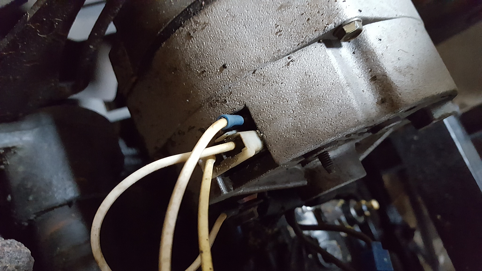

This is a picture of my alternator if it uploaded. Is this the 3rd spade that's referred to on aftermarket alternators to make the tach run? Mine isn't moving and trying to track down the issue. Thanks in advance.

Wire is to the right place. Is the alternator charging? I don't think the tach will work if alternator isn't

It should be working. Although light is on at idle on start up but quickly goes away when you throttle up.
