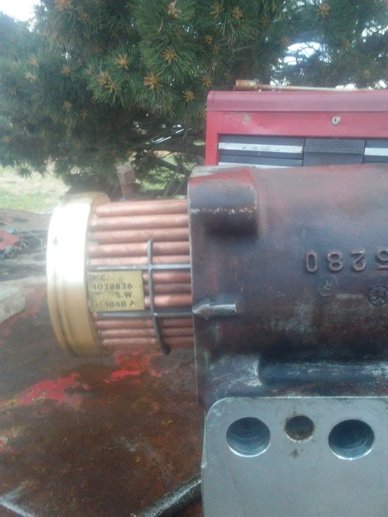

I just done this little project on my 7060,,, its not a big a job as it looks,, I think the worst part is having to drain the coolant and replace,, lol,, yes getting the cooler out of the housing can be a little tough, I just lubed the O-rings up real good and all went back together real neat,,,the new O-rings are all black,, so need to watch part numbers an get the right ones in the right place,,
 might try a search,,, I don't remember if I put pictures up or not...

The cooler core must be "timed" in the housing or it is pretty much ineffective in cooling the engine oil.
Please explain by "timed"? On my many visits to the assembly line I never noticed that ether one of the 2 assemblers who built up these cooler assemblies ever timed (indexed) the tube nest to the housing. They did use an assembly fixture that the rear elbow, cooler housing and front end cap with water tube were mount to for proper alignment while tightening the capscrews.
Points: 22826
Post Options Post Options   Thanks (0) Thanks(0)   Quote DrAllis Quote  Post ReplyReply Direct Link To This Post Posted: 20 Jun 2018 at 9:29am
There is an "arrow" on one end of the cooler tube bundle and there is another arrow on the front (inside towards the eng block) of the housing. They need to be close to each other but not perfect. If that cooler core is assembled 180 degrees off, there essentially is little or no oil cooling.
OK good to know. Don't recall ever seeing an arrow on the tube nest (bundle) but, do seam to recall seeing a arrow cast on the cooler housing. Thanks again for refreshing my memory. Handshake

here ya go ACjackmay not be able to see in the picture, but theres an arrow on the little tag on the tubes
