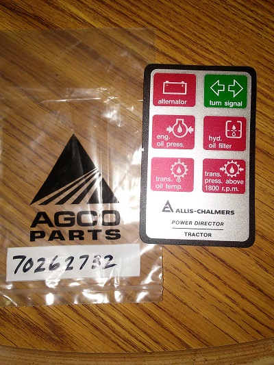

Post Options Post Options   Thanks (0) Thanks(0)   Quote Michael V (NM) Quote  Post ReplyReply Direct Link To This Post Posted: 30 Aug 2021 at 9:30pm
here ya go, this is what ya get,,, set down when you get the price quote, ordered this one for my '76 7060 red belly...
Edited by Michael V (NM) - 30 Aug 2021 at 9:31pm
Points: 8918
Post Options Post Options   Thanks (0) Thanks(0)   Quote Mikez Quote  Post ReplyReply Direct Link To This Post Posted: 02 Sep 2021 at 10:36am
that says power director. His is power shift
Michael V (NM) View Drop Down
Location: NM
Points: 2555
Post Options Post Options   Thanks (0) Thanks(0)   Quote Michael V (NM) Quote  Post ReplyReply Direct Link To This Post Posted: 02 Sep 2021 at 11:07am
Yea,, I know they are different, this was mostly for what it will look like, the original was prolly all red. go up or down 1 number will get you the PS version. this one came from Schmidt & Sons, Mt. Hope KS

70262733 is the power shift decal.
