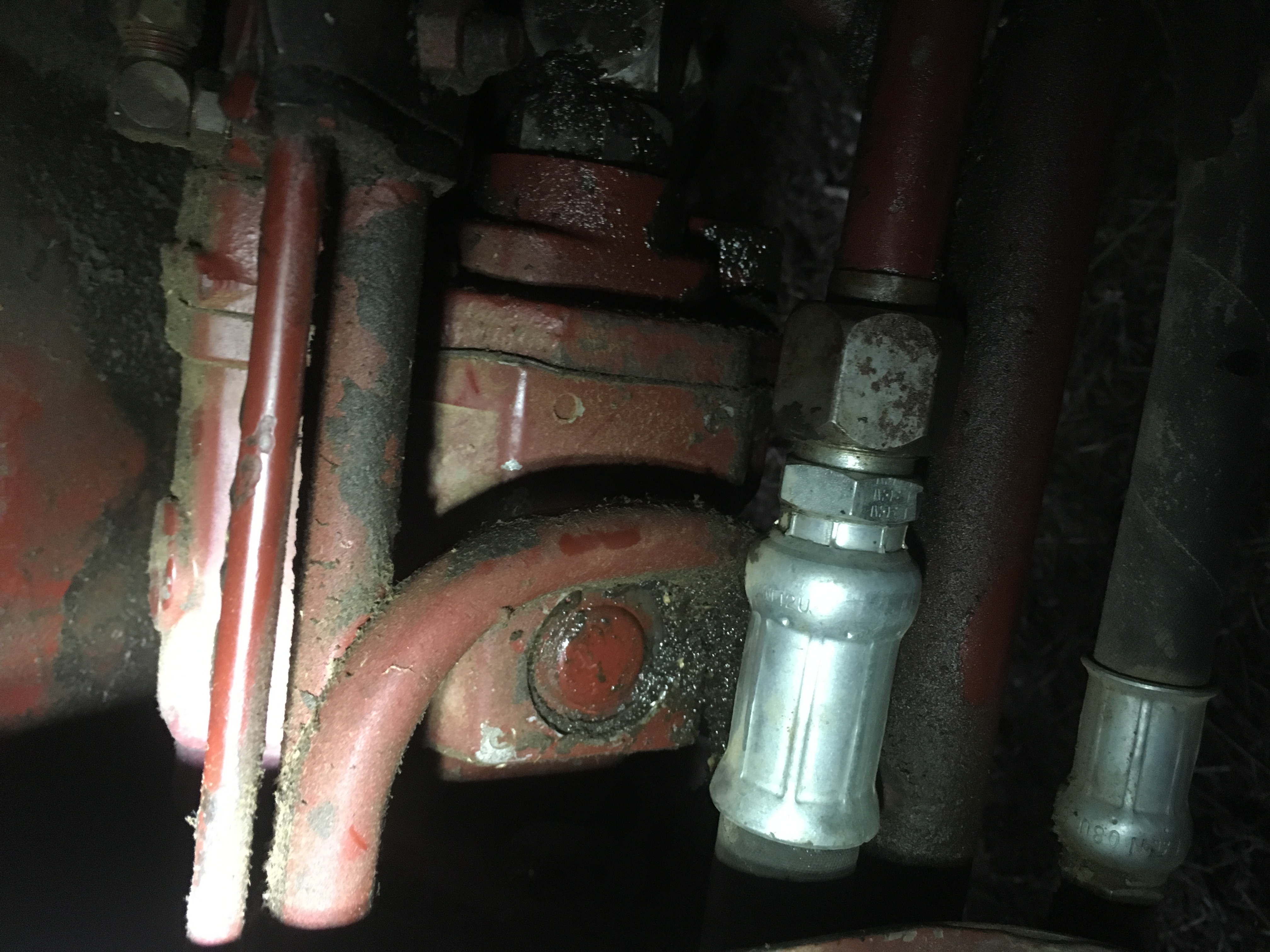

Post Options Post Options   Thanks (0) Thanks(0)   Quote ebowman Quote  Post ReplyReply Direct Link To This Post Posted: 10 Sep 2018 at 10:36am
Here is a picture of the leaking cap where I can feel the “clicking”
WD45, '62 D17 Diesel, '65 190XTD, '74 7030, 1958 Roto-Baler
Points: 22306
Post Options Post Options   Thanks (0) Thanks(0)   Quote DrAllis Quote  Post ReplyReply Direct Link To This Post Posted: 10 Sep 2018 at 11:02am
When you activate either remote to raise or lower (NOT FLOAT) the pump should stroke up and provide 2300 to 2500 PSI. You don't have to have any cylinders connected.   I'm not there, but I'm leaning towards something internal in the pump itself.

Post Options Post Options   Thanks (0) Thanks(0)   Quote Lynn Marshall Quote  Post ReplyReply Direct Link To This Post Posted: 10 Sep 2018 at 12:40pm
Pulling the snap ring and that thin cap won't let you see inside the pump. The needle bearings for the swash plate to pivot on are behind them. There is an o-ring behind the cap that could be replaced to fix that leak. I think that you have a bad piston in that pump.
