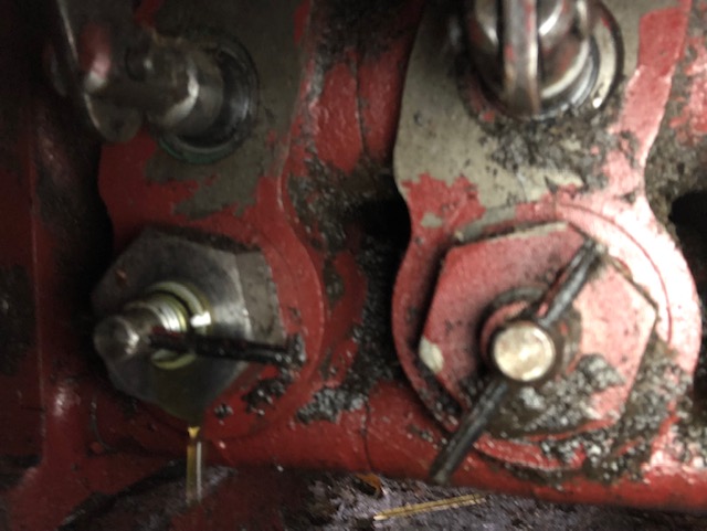

Help needed please!  Leaking hydraulic oil from flow control on a remote. I have screwed in the adjuster and slowed the oil flow but now cylinder remote is really slow. what do I need to fix this leak? I feel a little retarded on this one:(

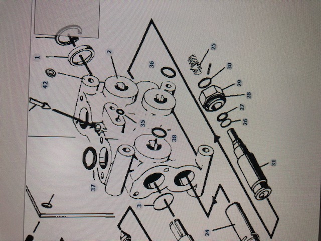

Remove the whole flow control assembly and reseal. Hopefully there's not too much wear on the parts. The left one has been worked on before. No paint on it.

O rings probably just need replacing in the valve body.  AGCO sold me a kit when I did the valve body on my 190XT.  They give you every seal you need.  Once you figure out how it comes apart, it's pretty straight forward.  Doesn't leak anymore.

Screw the assembly out, drive roll pin out and it falls apart.      MACK
