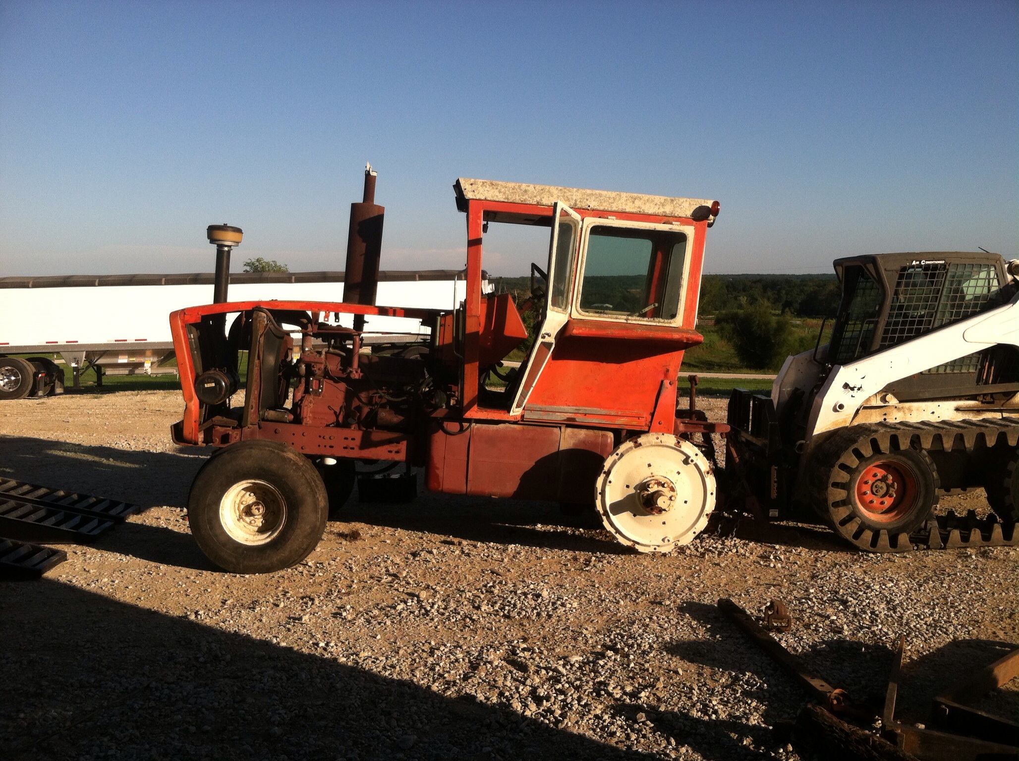

I bought this tractor today, and am considering making a puller out of it. I want to start out in super field, and eventually graduate to hot farm class. Will the 3500 series engine hold together as good as a 3700? Will the clutch handle it okay, or should I go ahead and add more plates? Rules would be 10,200 lbs, 2900rpm, roosa .450, water injection, 3lm466 or equivalent turbo, and no intercooler.
Edited by 7060 - 04 Sep 2014 at 11:00pm
