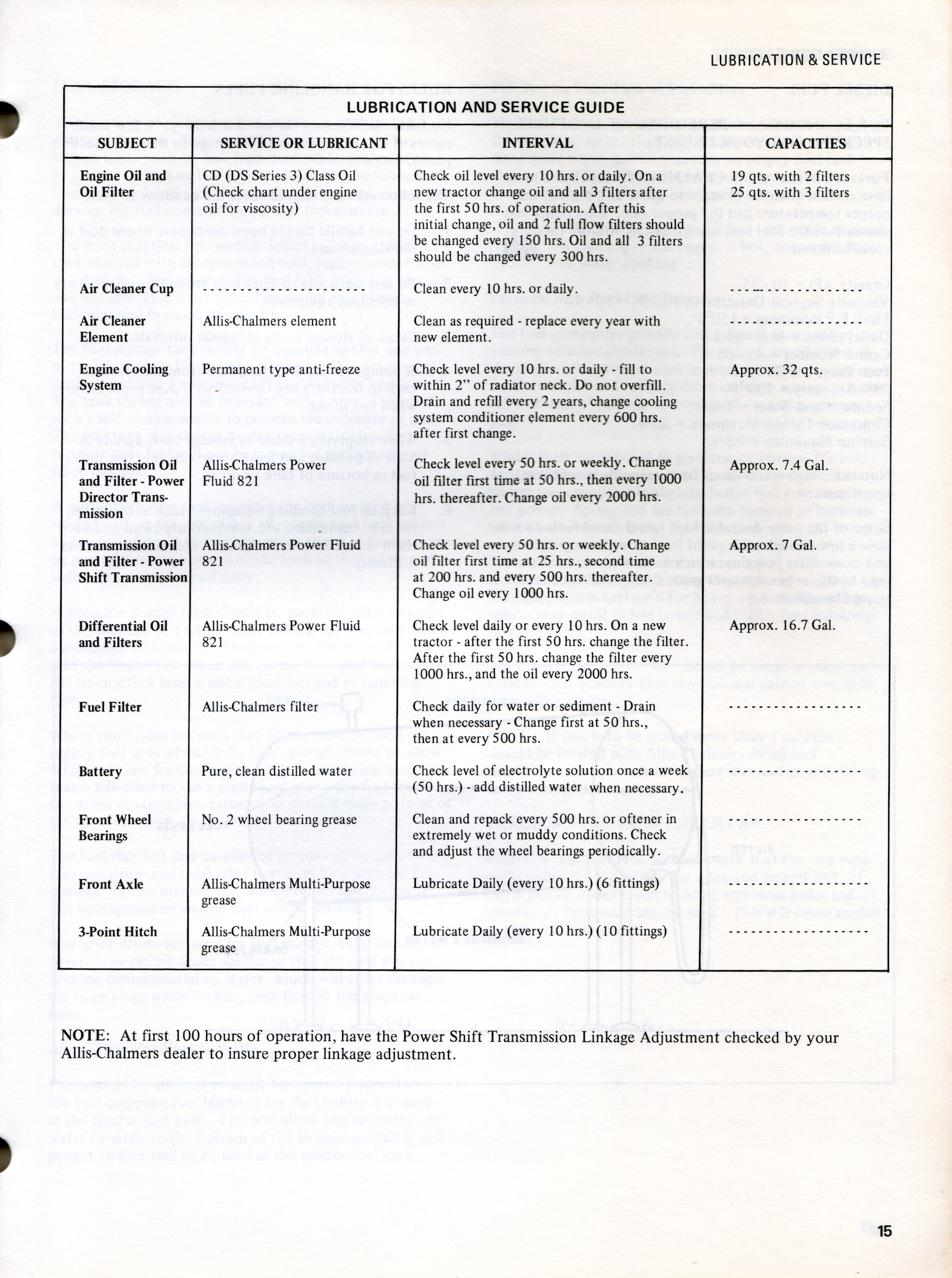

well that's great and all but about as helpful as a rock is hard, does anyone have a copy of how much fluid goes into each spot and where to fill it. my tractor has about a 2 inch plug with a dipstick on the floor under the seat and another plug with what looks like possibly could have had a dipstick attached so far about the only thing I could figure out was how to change the powershift filter but are there separate filters for the main hydraulics? if so I cant find them if anyone knows where to find some good original manuals that would help a ton. thanks

LB0442 View Drop Down
Joined: 27 Dec 2014
Location: Boise ID
Points: 767
Post Options Post Options   Thanks (0) Thanks(0)   Quote LB0442 Quote  Post ReplyReply Direct Link To This Post Posted: 17 Jun 2020 at 10:20pm
This is from a maroon belly 7060 manual.
