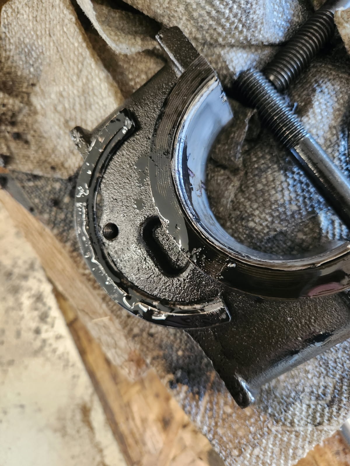

Post Options Post Options   Thanks (0) Thanks(0)   Quote nowaktj Quote  Post ReplyReply Direct Link To This Post Posted: 4 minutes ago at 11:30am
This engine, out of a M2 combine, I plan on putting into a 7020.   I noticed excessive crank end play so pulled the pan to discover the clutch side of the #4 bearing has the shoulder wiped off of it.
What would have caused this?   I plan on putting in new main bearings but if the crank is cut wrong or ??, I don't want to throw my money away.
