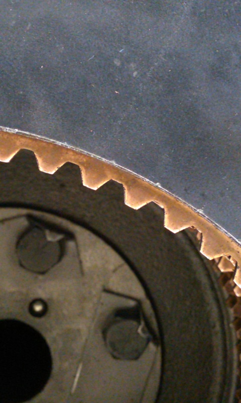

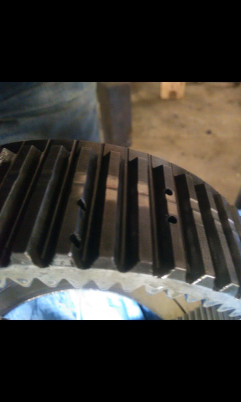

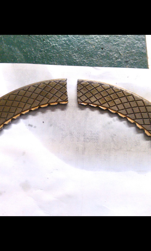

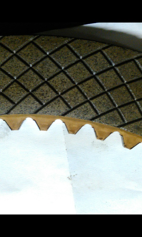

7010 started leaking oil bad from PS input shaft so we split it and found the  first cup bearing had gone and locking ring broke so tapered bearing also was loose. Next I noticed there was a problem in one of the  clutches.  2 friction discs broken and teeth chewed up.  Problem is I thought it was C1 that was bad so I ordered 4 discs for C1 only to find out it was C2 and they are not the same! C2 has rounder teeth apparently .  I have the clutch stacked together but not installed. Will the square teeth discs work? I assume C2 is different for a reason but thought Id ask on here in case i could save time and $   Theyre not cheap!        Thanks

THEY ARE DIFFERENT !!!!

Tribco has the correct discs for the C2 clutch. Should be a whole bunch cheaper than AGCo, as well as being kevlar reinforced.

Joe , Tribco has plates matching C2 part # but  in the pic he emailed me, the teeth  were definitely square like the rest of the clutches..???  maybe wasnt right pic?  i tried uploading it here, but didnt work.
