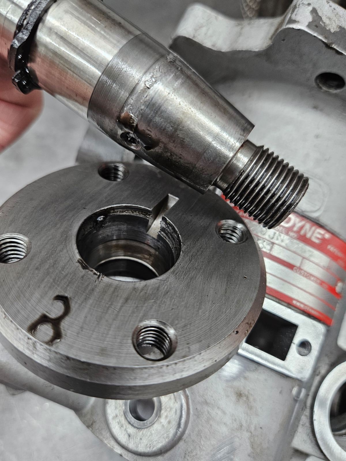

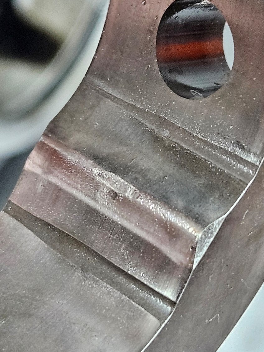

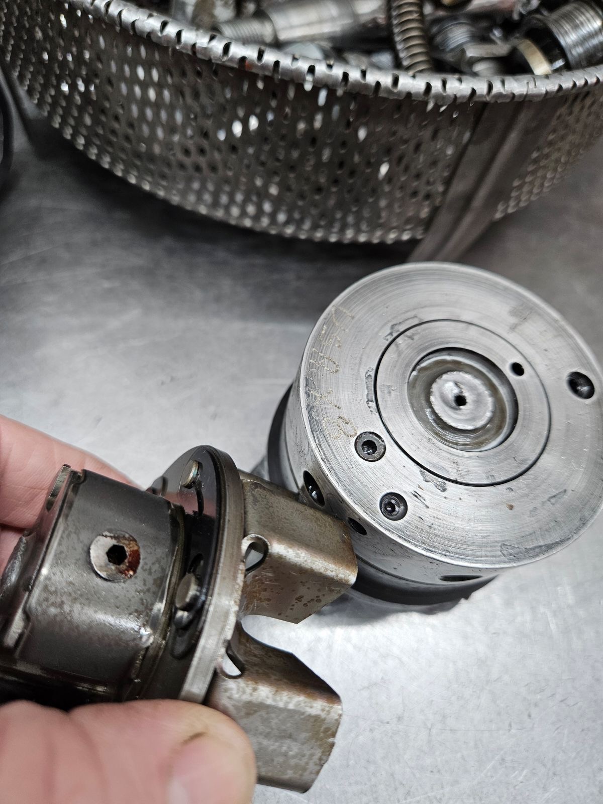

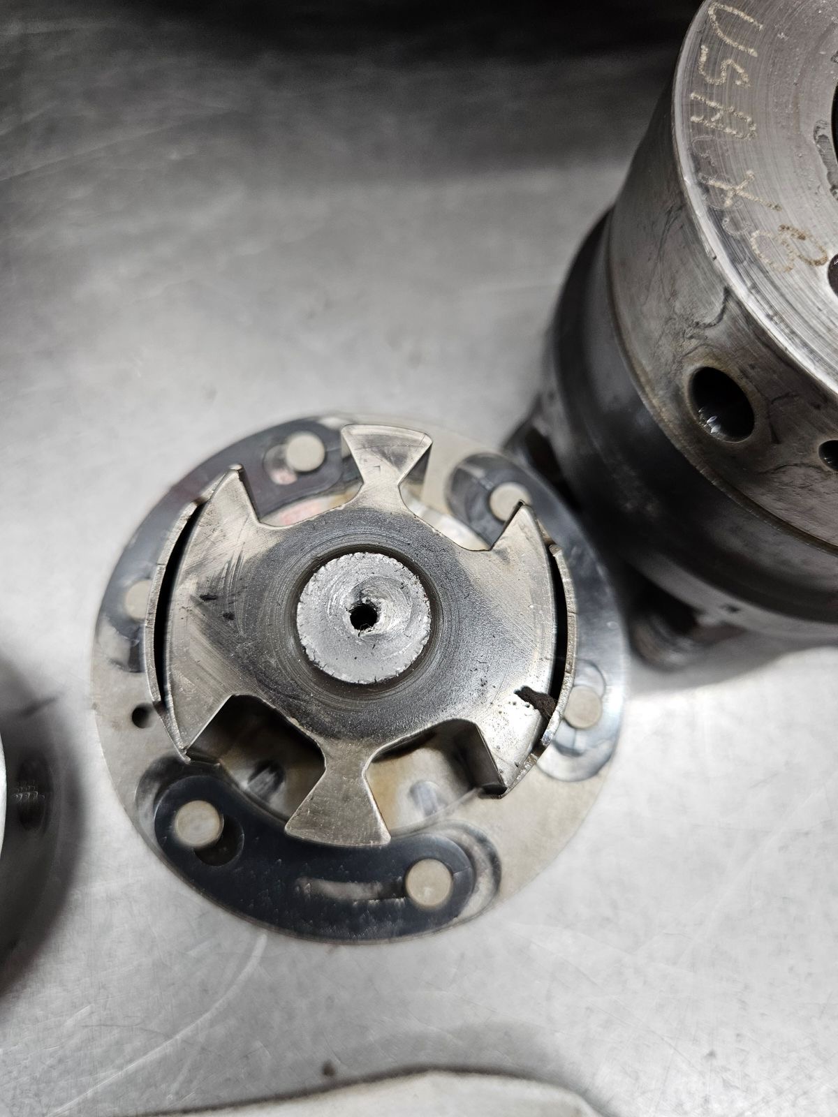

Post Options Post Options   Thanks (0) Thanks(0)   Quote injpumpEd Quote  Post ReplyReply Direct Link To This Post Posted: 10 Nov 2024 at 3:42pm
well, I got the St Jo pump in and apart, sadly the head is seized. The leaf spring screws had backed out quite a ways(had to be really low on hp) to the point one of them began hitting the lobes of the cam ring. So with any internal unhappiness, they end up seizing up. It looks like the cam ring had been replaced as well as the head and rotor being a rebuilt one by the looks of things. The DM pumps use shoes that are .005" difference in sizes, and a lo hp app like a 7010 would use -020 shoes, that keeps the leaf spring screws in most of the way letting their nylok patch hold them in place. Well, this one has new looking -015 shoes so in order to close down the roller setting the leaf spring screws would be out further, therefore allowing them to simply back out. I texted Gary some pics, so hopefully he can post them up, I am not smart enough lmao! Sad to see the poor work coming out of the big shops, and they won't back it. This had to be making horrendous racket while the screw was hitting the cam lobes, could have saved the head if it would have been parked and pulled off before catastrophic failure. Looked closer and it has -010 shoes which is even worse. Almost like they only want to stock the one size. The leaf spring screws are loose, the one that hit the lobes turns with my fingers.

Post Options Post Options   Thanks (0) Thanks(0)   Quote injpumpEd Quote  Post ReplyReply Direct Link To This Post Posted: 12 Nov 2024 at 8:48am
Thanks Gary for getting the pics up. Hopefully your other pump that flew apart will have a good head & rotor in it. I have a new h&r in stock and warehouse has several too, but the $1600 price tag stings! There's lots of these DM pumps around to steal parts out of yet.
You can see the screw is worn down on top, and the notch in the center of the cam lobe is from it wearing on it. Any side load on the rotor will cause it to seize. This could possibly have been saved if it was noticed to be making more noise than normal. I'd never seen this before, so I would not have guessed this was happening.
