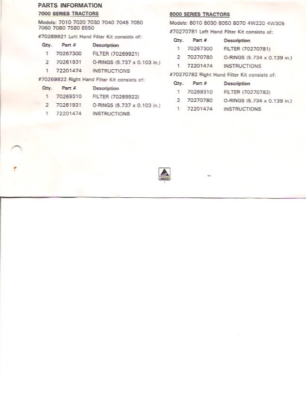

I dug out the old O ring it does appear to be fine. The CARQUEST 's indeed appear to be Wix filters. Guess I'll break out the calipers and double check the thickness. Funny the left side didn't leak.

there are 2 o rings. make sure the safety switch above filter is not leaking

Well now. The right hand filter kit only came with one o ring. Apparently the previous also only came with one. Because there was only one in there. How it didn't leak previous is beyond me. So I reused the one old o ring and now everything is tight. I'm still going to do a total oil and filter change with 821 or Hytran before winter. As to price Agco filters are nearly three times as much money as my price(I get shop discount) on CARQUEST filters.
