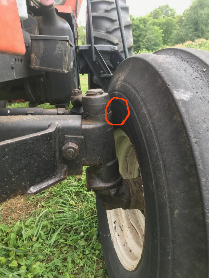

Had a flat tire on my 7010 and got to looking at it and the outside of the tire is rubbing against the spindle.  The other side has a good 1 inch clearance from tire to spindle.  Since these distances are different, there must be a way to adjust the distance?  There is a big nut right there.  Both tires are 11.00-16 F2.  If they can be adjusted, what is the procedure?  Does the tie rod have to be loosened as well?  Even worse, tire people are telling me that I have to get a new rim because the tire isn't sealing.  We already tried a tube and it failed so this is my 2nd flat tire.  Any help is appreciated.

normally that is caused by a failed wheel bearing.. have you tried wiggling the wheel hub on the shaft ?  You can get some loss of clearance if the king pin bushings are worn, but probably not 1 inch.

Post Options Post Options   Thanks (0) Thanks(0)   Quote calico190xt68 Quote  Post ReplyReply Direct Link To This Post Posted: 17 Aug 2020 at 1:09pm
I never thought about that.  I will inspect the bearings and hub.  Funny you say that.  I was reading in the 7010 operators manual and it suggested changing the wheel bearings on a regular basis like once a year.  I had never heard of that frequency.

Post Options Post Options   Thanks (0) Thanks(0)   Quote Boss Man Quote  Post ReplyReply Direct Link To This Post Posted: 17 Aug 2020 at 5:01pm
Wheel bearing or wrong offset on the rim. Had an IH come in and somewhere along the line someone changed the rim. After checking for a bent spindle and bad wheel bearings. I happen to look at the rims and they were different from side to side.

Post Options Post Options   Thanks (0) Thanks(0)   Quote Tim NH Quote  Post ReplyReply Direct Link To This Post Posted: 17 Aug 2020 at 5:43pm
I had to get a replacement rim for my 7000. The tire is close to 2" from spindle. The other side is original, and is a little over an inch. Also your rim is mounted 180' different than mine.

Post Options Post Options   Thanks (0) Thanks(0)   Quote steve(ill) Quote  Post ReplyReply Direct Link To This Post Posted: 17 Aug 2020 at 8:28pm
TIM has a good idea... make sure the tire / rim are not turned inside out..

Post Options Post Options   Thanks (0) Thanks(0)   Quote DSeries4 Quote  Post ReplyReply Direct Link To This Post Posted: 17 Aug 2020 at 8:52pm
Take the tire off and grab the hub and try to move it back and forth.  If there is a lot of movement, the drop spindle and bushings are worn out.  I had to get a new spindle made for my D21 in the winter because it was so worn.  At the top it wears closer to the engine and at the bottom it wears closer to the wheel.

Post Options Post Options   Thanks (0) Thanks(0)   Quote calico190xt68 Quote  Post ReplyReply Direct Link To This Post Posted: 17 Aug 2020 at 10:00pm
Thanks for all of the feedback.  The good dr. is right.  I reread that and it said remove, clean and repack bearings at every 500 hours.  I did shake the hub and it has very little movement and play so I think the hub is good and bearings good, but I am going to replace  the bearings while I have it off.  Never thought about a reverse on the rim either.  One of my friends said that he believes he bent a spindle due to hard use at some point on his JD and thought that could have happened to mine.  I can't imagine how hard you would have to hit something to bend those spindles but maybe it is true.  He has the same issue with one side being much closer.  I have come to the conclusion there is no adjustment and no one has mentioned that.  My 190xt nearly had the wheel fly off this past year in road gear due to worn bearings so I am replacing both front sets on both tractors after that near scary incident.  I have a spare tire that someone gave me but it is the 14L size versus the 11.00-16 F2 that I have.  Tire won't fit without rubbing.  However, I think the rim is the right size, so am considering removing the tire and using this rim.  Does a 14L have a different rim size?  Tire guy said my tubeless tire wouldn't seal on the rim I have so will try this other rim instead. if it fits  Most likely have to buy a new tire.  Oh well, new bearings and new tires should be a good thing in the long run.  As long as they are installed right way.  I would think that the valve stem would be on the inside versus the outside if it was reverse?  I will report back when I figure more out.

Post Options Post Options   Thanks (0) Thanks(0)   Quote Lonn Quote  Post ReplyReply Direct Link To This Post Posted: 18 Aug 2020 at 6:51am
Your 14L tire most likely takes a wider rim and I bet it is 14L x 16.1 and that rim from that tire will not work for a 16" tire. You need to have the right width rim with the right offset.

Post Options Post Options   Thanks (0) Thanks(0)   Quote Gary Quote  Post ReplyReply Direct Link To This Post Posted: 18 Aug 2020 at 7:21am
I'd switch tire and rim assembly's from side to side and see if there is any difference.

Post Options Post Options   Thanks (0) Thanks(0)   Quote calico190xt68 Quote  Post ReplyReply Direct Link To This Post Posted: 18 Aug 2020 at 7:25am
Thanks.  May have to get another rim then.  I continue to wonder if the rim I have is original or not.  Since offset is wrong from the spindle, the bearings seem to be good and there is no adjustment, maybe I have wrong rim anyway.  I checked on miller tire and they only offer one rim in the 11.00-16 8 lug style.

Post Options Post Options   Thanks (0) Thanks(0)   Quote Tbone95 Quote  Post ReplyReply Direct Link To This Post Posted: 19 Aug 2020 at 7:11am
Originally posted by calico190xt68 calico190xt68 wrote:
Gary, that is a good idea.  While a minor hassle, it would clarify everything for me.
I guess you could go through the work of swapping the tires side to side, but I'm thinking a straight edge and tape measure could easily tell you the same thing.

Post Options Post Options   Thanks (0) Thanks(0)   Quote HD6GTOM Quote  Post ReplyReply Direct Link To This Post Posted: 19 Aug 2020 at 9:21pm
Make sure you get a rim for a tractor, not a wagon rim. The centers on wagon rims are not as heavy as tractor rims. A salvage lot would be a good place to look. It looks like this rim is wider than necessary

Post Options Post Options   Thanks (0) Thanks(0)   Quote calico190xt68 Quote  Post ReplyReply Direct Link To This Post Posted: 20 Aug 2020 at 7:12am
I think I got to the bottom of this tire issue.  Turns out that the Firestone Tubeless tire is the size that gives me about the 1 inch separation and no rubbing.  The Harvest King Tube type is the one that rubs the tractor.  I used a straight edge and compared front and back offsets on the two rims and they are the same.  I asked my tire guy to get me a tubeless tire although he was having a hard time locating quickly a Firestone to match my other side.  The other problem is that they tried the last time it went flat and couldn't get a tubeless tire on the rim to seal.  So I have to get back operational and hope that the new tire works without rubbing and seals.   Not all 11.00-16 F-2s are equal.  He does have 4 rib Firestone versus 3 rib but I am not sure if that will create a rubbing problem.  I am also not sure what is better for haymaking, 3 rib or 4 rib? Does it even matter?  Finally, I ordered my bearing kit from all states ag so hope it is a match.  Should be here tomorrow/today and hope to have the tire tomorrow and operational for baling in the afternoon.  Thanks for the straight edge idea as it saved me some time and eliminated the wrong rim size idea.  Thanks for all responses as well.

Post Options Post Options   Thanks (0) Thanks(0)   Quote calico190xt68 Quote  Post ReplyReply Direct Link To This Post Posted: 20 Aug 2020 at 6:18pm
I got the new tire installed and it is a tubeless Farm King Crop Max 3 rib.  Not my first choice, but I was limited.  The clearance is now the same on both sides about 1 inch.  Apparently that tube type was not correct.  Tire guy said that rim was reversible so I could get more or less clearance by reversing it. Tim's might be reversed for that reason but I still have the valve stems on the outside so that is good.  I will buy a matching tire for the other side once hay season is over or it goes flat.  Will also install new bearings.  Now I got to get get outside and start raking and baling!  Thanks for the feedback.  Case closed.
