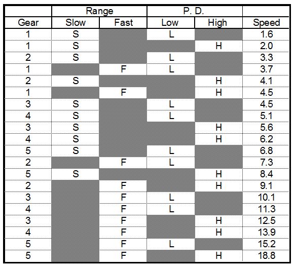

This is one that I made from the book, should be exactly the same:

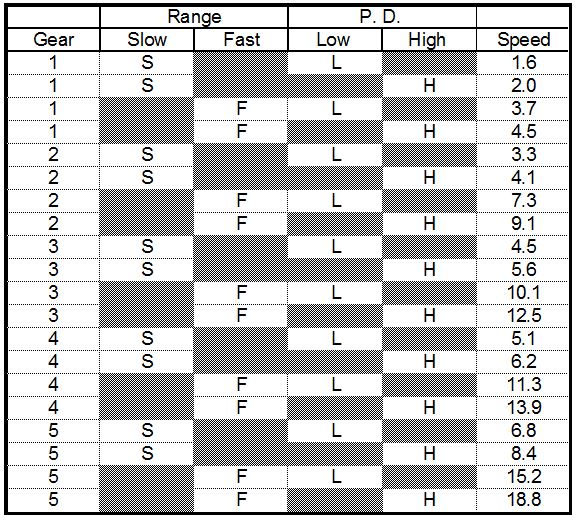

And another copy, sorted this time by the "speed" column:
