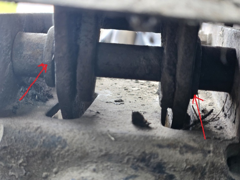

Post Options Post Options   Thanks (0) Thanks(0)   Quote calico190xt68 Quote  Post ReplyReply Direct Link To This Post Posted: 28 Apr 2025 at 1:05pm
Thanks for the part number and I do see those bushings.  Those bushings look like they are there.  See pictures below but I will take it apart and check them out.
I did loosen the cable clamps and also unscrew the tie rod end out on the lower cable end, then moved the cable clamp back, but it didn't matter.
So far, adjusting cable and clamp has NOT worked.  I can try to go shorter on the cable.  To me, it would need to be longer to allow the clutch to engage sooner though.  That's why I thought it would be good to extend the lower tie rod end.
The issue is that prior to the break in the bolt, I had to push the clutch pedal all the way to the floor to get it to shift without grinding.  Now I can't even do that.
That fork with the bushings via a spring causes a small rod to pull out of the hydraulic manifold.  It is almost like that small rod isn't coming out far enough?  Not sure how to make that happen.  There are spings that can be tightened or lossen to do that?
If I take it loose to inspect the bushings, could I pull out on the rod and see how far it comes as a test?
Here is what I see:
Another view showing the bushings.  I suppose they could be worn down on the inside.  I will remove.
Points: 22770
Post Options Post Options   Thanks (0) Thanks(0)   Quote DrAllis Quote  Post ReplyReply Direct Link To This Post Posted: 28 Apr 2025 at 1:11pm
Zero clearance where you are measuring it will give you the BEST transmission brake. You must go to the bottom with the pedal to fully apply the trans brake. Make the cable shorter not longer.
