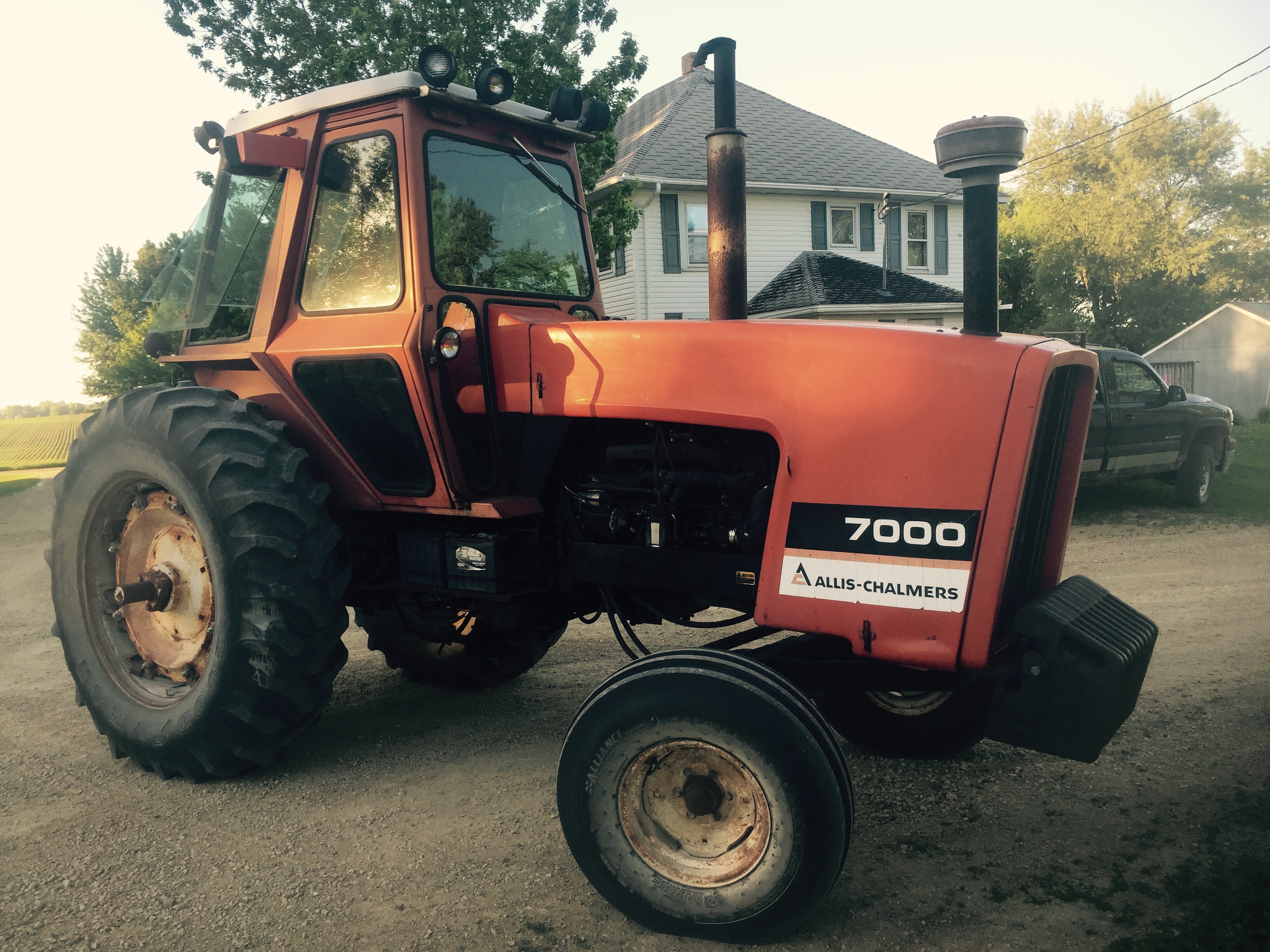

So I just purchased a 7000 and in driving it home I noticed that when you throw up the engine revs up slower than I feel it should. It's not "snappy" like my 190 and 185. And when you pull down fast it kills engine just like fuel shut off. Was told the fuel filter was just changed before I picked it up. Could it be pump, I'm just not sure
