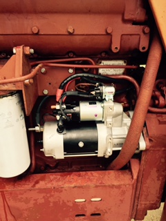

I traded recently for a 7060 with a weak starter. Wasted $60 on a new solenoid that didn't help much and I didn't want to rebuid what I had for a couple of reasons. I like gear reduction starters but couldn't find one listed for the 426. Searched here and found an old post from the Jorstad Brothers about getting one from the Generator Starter Shop in Billings Mt.
I called and the phone was answered by Dani. She is the co-owner. I told her what I was looking for and she gave the phone to Mike who within 5 minutes confirmed they had a starter in stock that would work. Back to Dani and she took my info and said it would ship that day. I don't think I was on the phone over 10 minutes.

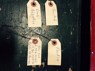

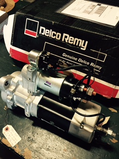

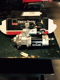

The starter fit perfectly. Very well packed and they even took the time to tag and label all the connections. This starter has a ground lug which I really like. You may have to make a new cable or two but that's it.
The starter spins the heck out of this old girl. I am very impressed with the starter and the service I recieved.

As I said, I like the looks of your starter. It's a genuine Delco too. I don't think you paid too much.

You got a part number on that starter? Would help a lot of us out.
7095-685I at 255hp, 8070-225HP,8050-210Hp,8030 with 155HP,220 with 670T engine with A-pump, 7580, 185 with 140HP, 2-6080's,6070, S4 D17,wd45,CA,st34 agco, S1 D17 with 3500MK2
lowell66dart View Drop Down
Joined: 10 Jul 2013
Location: Paulina La.
Points: 964
Post Options Post Options   Thanks (0) Thanks(0)   Quote lowell66dart Quote  Post ReplyReply Direct Link To This Post Posted: 08 Jun 2017 at 6:45am
Here you go.
8200433 39MT
