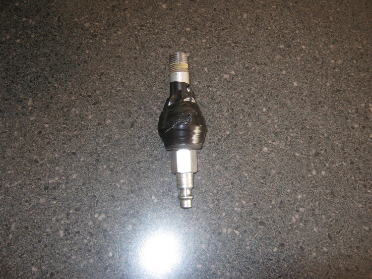

I didn't have good luck w/ my OSHA approved air blowing nozzle. So I made up a gem. Set regulator at 60 lbs. In 2 seconds I heard the 3 pt hitch come up. The steering worked, and the light is off.  Thank you Mack.  Tim
