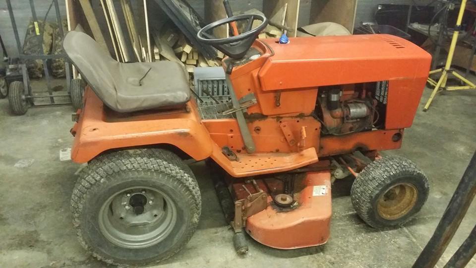

I was just offered what the current owner believes to be a 712 but it has what he says is a 10 horse. Here's the numbers I've gotten:   ID 1690727, Engine 14863 A. Owner says it's K241S. Any help or leads greatly appreciated.

The engine numbers are for a ten horse.
10 hp = K241
12 hp = K301
14 hp = K321
16 hp = K341
18 hp = K361
The tractor ID# 1690727 Comes up as a 914 Hydro. That tractor should have had the K321 engine.

Yeah! LOL! Those block windows are hard to work around! I've posted the picture and description that I received from the owner. I've found several different models in about the same shape for much less. Then again A-C guys are few and far between here. Everybody wants those yeller cubs or "frogs" (JD's).
"$400 Freetown Indiana has 42" deck runs and drives strong tractor needs voltage regulator battery and muffler. (Muffler blew out, put too much heat on regulator and subsequently battery went bad sitting dead, all this while it was loaned to my brother this past summer)"

Yep that would be a 914H with a 10hp repower. If it had the correct engine in it I could see the $400 but probably not with the repower. That is not a Simplicity/AC spec engine.

That ole' girl is pretty straight. Not bad even though its repowered with the incorrect engine. I like the 700 & 900 series Tractors. They are tough old dogs...
