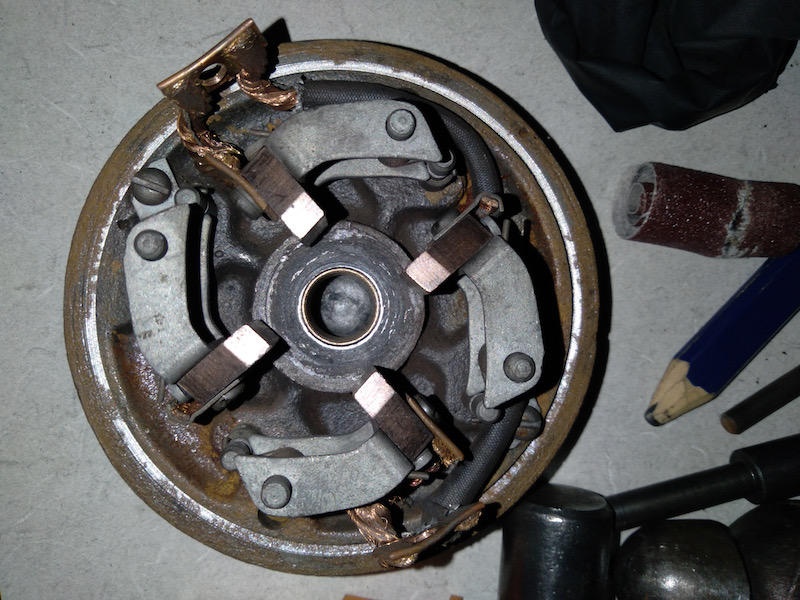

Is there a way to tell what windings I have in my Delco starter from my WD? I am assuming they are the original 6V, but the tractor was converted to 12V at some point, so I was wanting to check in the off chance someone had actually converted the starter at the same time.
I currently have the starter apart and am about to put it back together.

It would take someone more knowledgeable than me on starter windings to answer that, but I do know, at least in these parts, it’s rare to see someone going ahead and having the starter wired to 12 volts when doing a 12 volt conversion, unless the starter was bad at time of conversion I think most people just run the 6 volt starter on 12 volts until they have a problem with the starter.
You might could try a 6 volt battery after the starter is back in the tractor, and If it has been converted to 12 volts , I don’t think the 6 volt battery would start the engine. But I’m guessing there on how powerful it would still be on 6 volts.
You might post some pictures of what you got since it’s apart and maybe Steve will see it and be able to answer your questions.
But I bet it’s still 6 volts, was it pretty dirty and dusty in there, like it hadn’t been apart in years?

Thanks Steve - so how do I tell if my starter is set up for 6V or 12V? Is there some way I can check the field coils with a multimeter, or can you visually tell?
I did finally get to the pictures today but I'm not sure if you can tell anything from them. I replaced brushes and bushings, and cleaned up the commutator.

I am certain that there is a measurable difference between 6 Volt and 12 Volt field windings (using a suitably sensitive ohm meter) but I have no idea what the exact numbers would be.

There's many, many variables of parts in these old units, and as Les mentioned, you need a book of winding specifications in order to ID certain parts, especially field coils. I usually don't have time to mess around trying to find out what a old unit has, I just tear em' down and build them to my specs (whether 6 or 12V) and start fresh and custom build them for the customer including the Armatures. This is why I warn folks about how these old units can operate running 12V's through a 6V unit. Some are more violent than others, but the problem is there as Les witnessed with his particular application.  Other guys have been lucky and haven't had problems. I like to do things the correct way, whether its for me or a customer. But that's me. Some may have a handful of Starters kickin' around, so if one fails, they toss another one in. If it works, hey its good!    LOL!

If it looks like the field coils have never, ever been removed ...odds are they are 6V coils. In a proper 12V conversion, they'd have to be replaced, and you'll see some kind of scrapes,gouges, missing paint, etc. something.......

To summarize, it sounds like:
-Nobody knows how to ID the field coils
-Some people have run unconverted 6V starters with 12V batteries with no issues
-Some people have done the same but had issues, worst of which involved splitting the tractor to fix
The options are:
-Run it as-is and risk being one of those that experiences harsh engagement and breakage (free, at first, and then maybe not so much if the ring gear or something gets destroyed)
-Pay up $$$ to a place that specializes in starters etc. for rebuild
-Convert back to 6V battery
-Try to find Delco/Remy literature on how to ID parts and rebuild the starter
I am the sort of person that does all of my own work minus automotive tires and some engine machining, so it would be really nice if I lucked into a Delco/Remy manual somewhere, but I'll have to keep digging. Realistically going back to a 6V battery may be the cheapest and easiest option if mine engages the ring gear like a sledgehammer.
