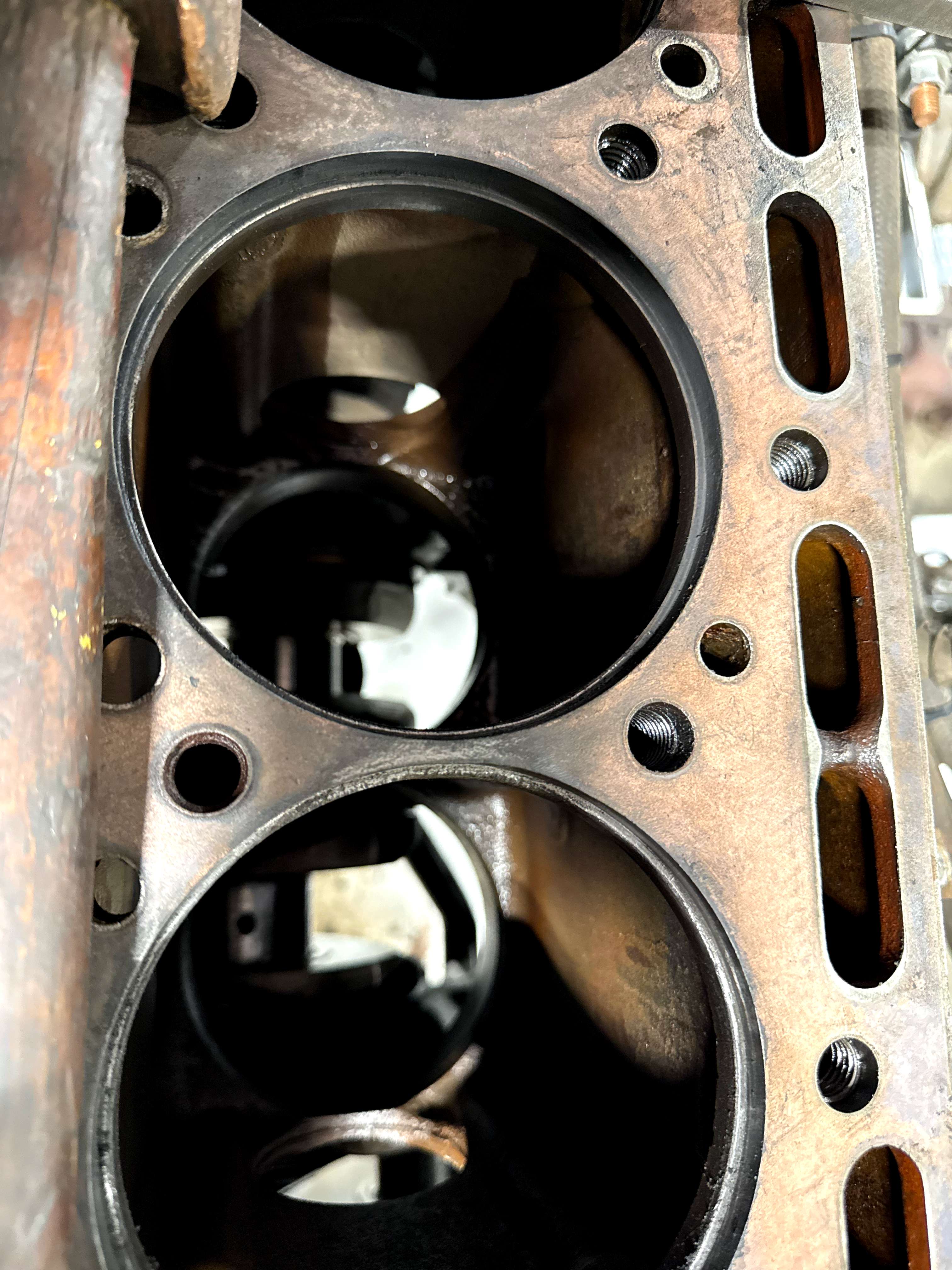

Hi all, I know this has been touched on before and I did a search but didn't find what I was looking for;
What is different between say a late L3 670T engine block and an 8000 series engine, specifically the 8030. They're both rated at 158hp but from memory they can't be swapped without some modifications. ....just can't remember what they are.
Back story, my 8030 started pushing air into the coolant.. leaking around one of the sleaves, block corroded, pulled already and at the machine shop. They are going to have to get oversized sleaves and mill those to fit after cleaning up the block.
Or, find another block, but all i can find locally is combine blocks.
I'm more of a "bird in the hand" type and would rather work with what i've got rather than invest more into a mystery engine only to find it needs work too. but thought I'd ask.
Thanks, Matt

They are the same. 670 - The front covers are different. The cranks on the highest hp are counterweighted but not the L3 or 8030. Front Pulleys are different. Fuel pumps may be different. Also. That is a very expensive way to fix the block . There are sleeves to press in the bottom if that is what is needed. We use an epoxy similar to JB weld to fill in the pits and hone to fit std sleeves tight. They have to fit tight - vibration = electroysis.
Also it is rare for a sleeve to be the source of pushing air into the coolant w/o putting water in the oil.

The year the engines were built helps see that they are the same casting. 8000 series was 1982 and up. As far as I'm concerned, you can go all the way back to 1973 with a 7030-40-45-50-60-80 and 7580. Block casting numbers will be different, but I can't think of one change to the block casting that would keep you from utilizing it in an 8030. Plug the piston cooling holes is about it.

Alright thanks! thought there was more than that
Basically it looks like this coolant issue was going on before i bought it, I ran it for a bit before realizing it was pushing air. I pulled the head, rebuilt it and put it back without pulling the liners. That bought me some time but the issue came back.
It looks like its been getting by the liner at the top where it sits on the block long enough its pitted etc. Expensive yes, but at this point I want it done right. Thought of the JB weld route but she's already at the machine shop.
Thanks, Matt

Also I finally did start putting coolant into the oil, but only just before I pulled it apart.
