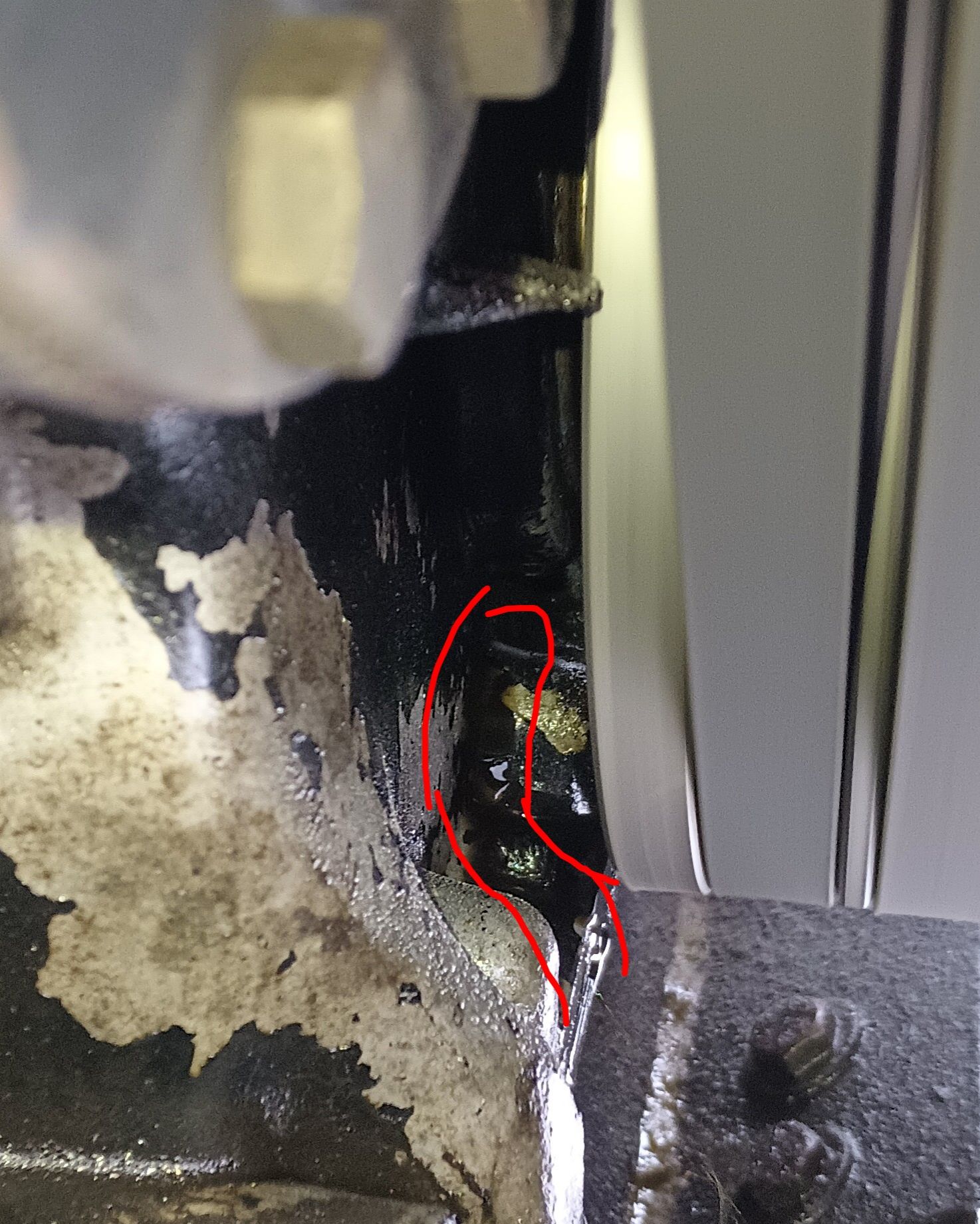

Post Options Post Options   Thanks (0) Thanks(0)   Quote Northern Hoser Quote  Post ReplyReply Direct Link To This Post Posted: 2 hours 43 minutes ago at 2:40pm
So here's the right side, has oil above the oil pan on the cover, hard to tell exactly where it's coming from but I'll double check the pan before getting in there
Points: 22538
Post Options Post Options   Thanks (0) Thanks(0)   Quote DrAllis Quote  Post ReplyReply Direct Link To This Post Posted: 1 hour 53 minutes ago at 3:30pm
Cracked cover ....??

Post Options Post Options   Thanks (0) Thanks(0)   Quote Northern Hoser Quote  Post ReplyReply Direct Link To This Post Posted: 19 minutes ago at 5:04pm
I'm wondering that myself. I gotta have a better look but didn't look like it was wet at the bottom of the seal and there isn't any oil being slung out by the balancer.
