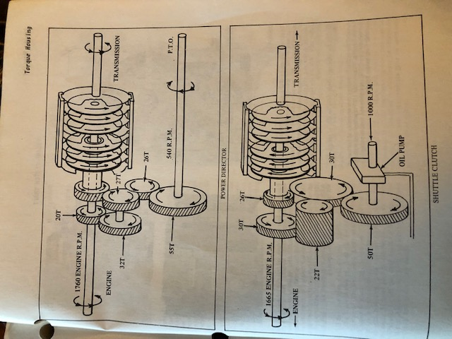

Here is a diagram of the power flow in the 621 forklift. The power train is
from the D-15.
Dean(IA)

Where did you find that page Dean?
Dean(IA) View Drop Down
Location: NE Iowa
Points: 430
Post Options Post Options   Thanks (0) Thanks(0)   Quote Dean(IA) Quote  Post ReplyReply Direct Link To This Post Posted: 15 Mar 2019 at 6:30am
this is a page that I constructed by cutting and pasting gears and shafts from
several pages of the parts book. I never did find the exact page with the
shuttle clutch intermediate shaft and gears. This part is how I think
it should work. Everything else is right out of the parts book.

That is a pretty neat graphic, Dean. I'm sure it took 10 or 15 minutes to get it all together !!

I wondered how shuttle clutches worked.  Once you see the concept (and wrap your brain around it) it is fairly simple really!
Thanks for putting this together Dean.

This is from the 615 Service Manual.
The 615 is based on a D15 Chassis.

This is the Service Manual page from JoeO(CMO) after some tweaking. tweaking.

Thank you Dean.  That is the set up I remember from the D-14 shuttle clutch - just smaller.
Sorry I could not be any assistance in your quest.
Good Luck!
Bill Long
ps:  You may want to include this in the Knowledge section.  I am certain others want to know.  Pop's Knowledge is Power book did not have this good a description for the power director
