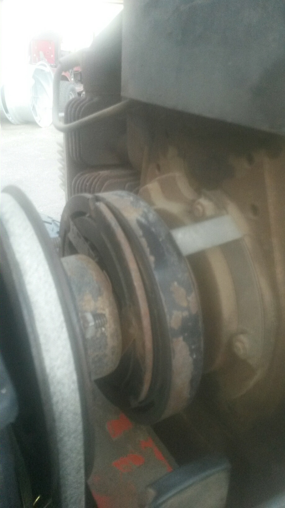

can anyone tell me if this is a terminal problem or what I need to do to fix it?  If you can't see from the picture, the plate that is on the front side of my front electric clutch is off-center.  any help would be nice.

Darrell, pretty sure the pressure fingers are broke . They actually don't pressurize it, but when current is applied, they allow the magnets to pull the plate to flywheel. I think warner electric is the maker. A better pick would help. HTH Tracy

Tracy, Yes there is 1 or 2 pressure fingers broken, can these be replaced?

Darrell, I would think so from a parts clutch. HTH Tracy
