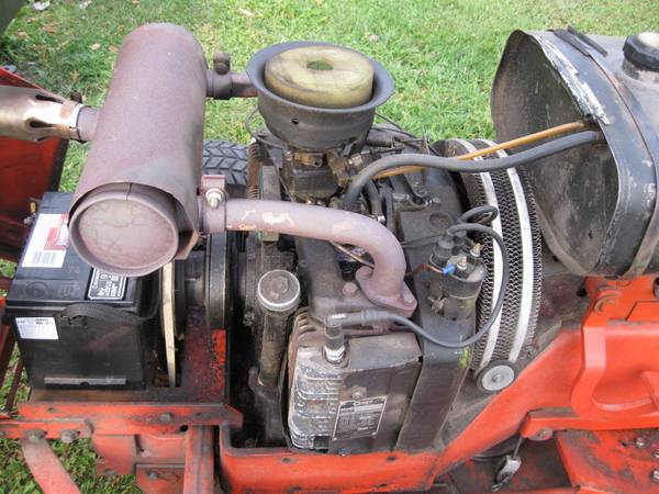

Post Options Post Options   Thanks (0) Thanks(0)   Quote AcFordHawk Quote  Post ReplyReply Direct Link To This Post Posted: 10 Nov 2014 at 5:42pm
616 CCKA:
620/720 CKB:

Post Options Post Options   Thanks (0) Thanks(0)   Quote coggonobrien Quote  Post ReplyReply Direct Link To This Post Posted: 10 Nov 2014 at 6:02pm
Good deal looks like all cckb Manifold are the same
Location: Gallatin,TN
Points: 10921
Post Options Post Options   Thanks (0) Thanks(0)   Quote Tracy Martin TN Quote  Post ReplyReply Direct Link To This Post Posted: 10 Nov 2014 at 8:02pm
The CCKA carb mounts to top of manifold. The CCKB mounts to side of manifold. HTH Tracy

On the 620/720, what is the cylindrical black part between the
manifold, carb and air cleaner. Maybe a crankcase scavenger gizmo?
Then look at the complex 90 degree formed hose connecting the air cleaner and intake side of the carb. Can that be purchased new?
And last, is the air cleaner a little on the small side?
Points: 10921
Post Options Post Options   Thanks (0) Thanks(0)   Quote Tracy Martin TN Quote  Post ReplyReply Direct Link To This Post Posted: 10 Nov 2014 at 9:51pm
Yes and yes. Hold onto your billfold! Tracy
