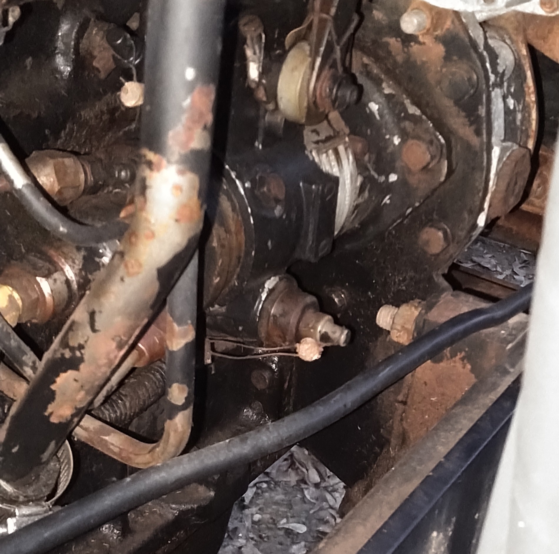

Post Options Post Options   Thanks (0) Thanks(0)   Quote ssefick Quote  Post ReplyReply Direct Link To This Post Posted: 14 Nov 2022 at 4:46pm
Here is a picture.
I assume this is the front cover dowel?
If so is there somewhere I can get an idea how to rebuild the front cover? What if it does not fit snuggly in the block? This is a major issue any non-rebuild fixes suitable?

Post Options Post Options   Thanks (0) Thanks(0)   Quote ssefick Quote  Post ReplyReply Direct Link To This Post Posted: 14 Nov 2022 at 8:01pm
The answer to this is probably no, but I figure I'll ask.
Can I put some locktite in this dowel and push into place from the fuel injector pump side?

Post Options Post Options   Thanks (0) Thanks(0)   Quote MACK Quote  Post ReplyReply Direct Link To This Post Posted: 14 Nov 2022 at 8:48pm
You can, but it won't stay. Fix it now or spend more later.                      MACK

Post Options Post Options   Thanks (0) Thanks(0)   Quote jaybmiller Quote  Post ReplyReply Direct Link To This Post Posted: 15 Nov 2022 at 6:09am
agree best to properly fix it
but......
 after to clean and locktite it in,
is there some way to  add a 'bracket ,bar, or ??' to wedge the pin in and prevent it from coming out ? maybe a threaded rod, 2 nuts to force pin back and keep it there ?
At least if mechanically secured, it'd buy you some time to research how the 'proper' fix is done. I'm guessing a LOT of stuff HAS to be removed to do it right though.....

Post Options Post Options   Thanks (0) Thanks(0)   Quote DrAllis Quote  Post ReplyReply Direct Link To This Post Posted: 15 Nov 2022 at 6:39am
If there are no serious oil leaks in the general area (oil pan/timing cover/front plate to block) pound it back in just below flush. Then, lightly peen the blocks hole to keep it from working back out. Keep all timing cover bolts tight, especially the bolts on the external thrust bearing. If this doesn't last, then you'll have to go deeper.   I thought this problem was addressed some months ago ??

Post Options Post Options   Thanks (0) Thanks(0)   Quote ssefick Quote  Post ReplyReply Direct Link To This Post Posted: 15 Nov 2022 at 2:40pm
Dr. Allis:
I did not report back about the oil leaks. I also didn't see this pin until last weekend.
What I did:
I tighted all front cover bolts to spec., and all oil pan bolts to spec. The engine does not leak at all.
I'll see what I can do. Thank you very much for your reply.
