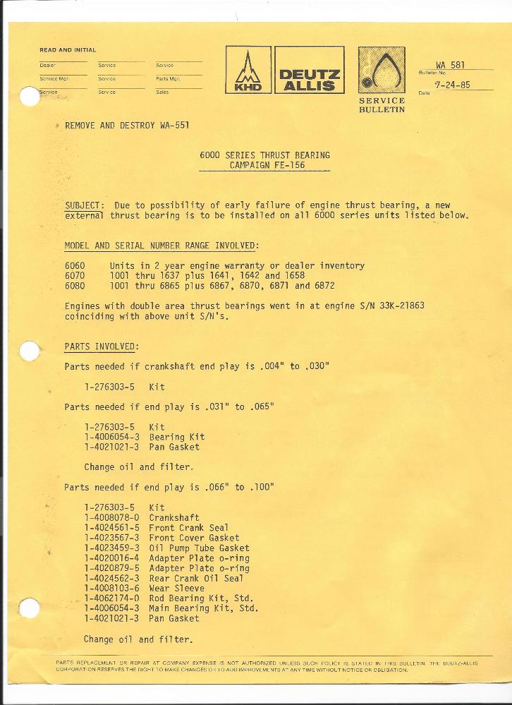

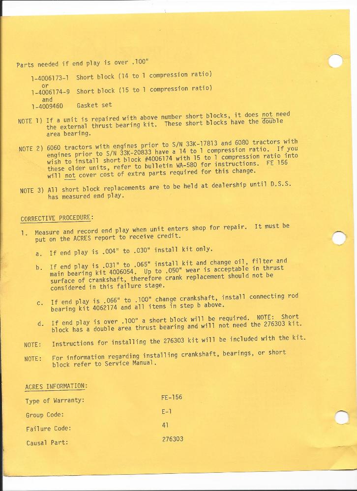

If the owner has the Owners Manual, get and read it.  The 6000 series is a Fiat tractor with an Allis engine.  The PTO is an abomonation,  tractor has a dual clutch.... one is for the PTO and operates with the long lever on the right the other is for the transmission and operates with the foot pedel.  The long lever should always be in the forward (engaged) position.  You only puill it back to stop the PTO while operating a piece of equipment.  You use the push/pull lever on the left to disengage the PTO.
When the long lever is pulled back it puts pressure on the crank and in time it will ruin the crank bearings.  The "bra" is simply a bracket across the front of the engine with a bearing that puts pressure on the crank in reverse of what pulling the lever back does.
I do not know how you would tell if the crank bearings were damaged, maybe Dr Allis or someone will chime in here.

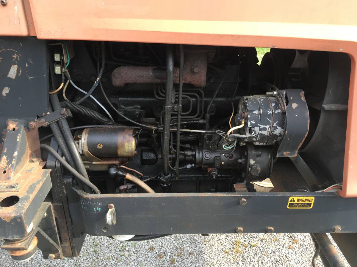

If you look at the crankshaft pulley and it is 100% open to the front, it doesn't have the kit on it.   If it has the kit, you cannot get the fan belt off the crank pulley, without somewhat disassembling the kit.

You can get an idea of the thrust bearing wear by leaving the PTO lever forward and use a crowbar or something similar to pry the front crankshaft pulley forward and backwards in the engine.

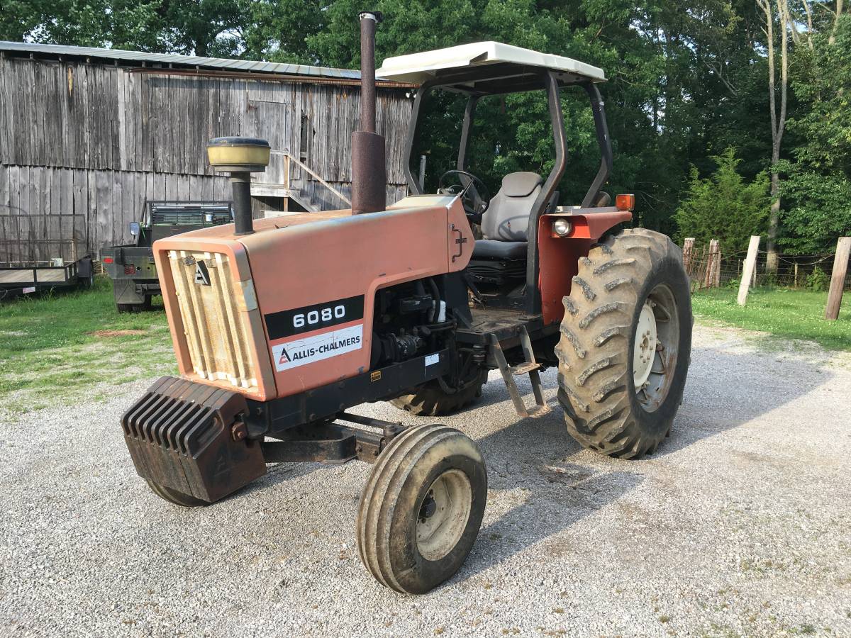

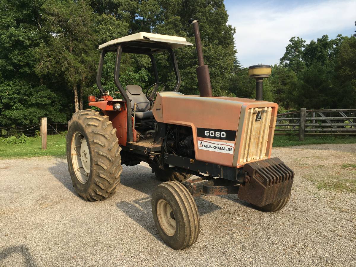

According to the pictures, the meter shows 5,703 hours.
Seems I'm having trouble adding another picture.  This will give a flavor though.

Don't see a bra but it may be okay. Be nice if you could figure a way to pry back and forth on crank pulley just to see how much "clunk" was there. Looks like a keeper to me. New fluids and proper lever operation may get you many trouble free hours. Good luck!

The crankshaft thrust kit isn't on that tractor.
