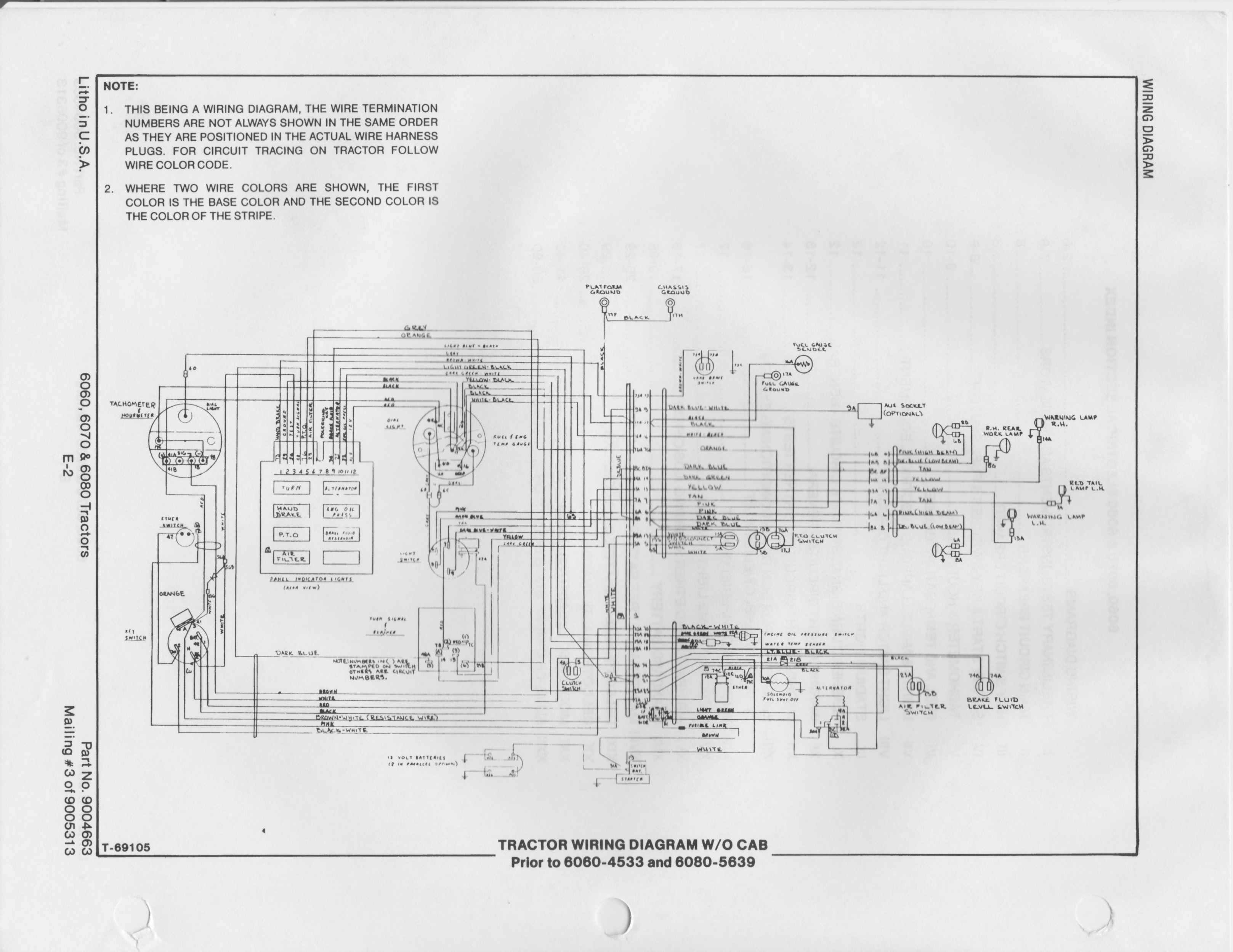

Here is a wiring diagram.  Looks like the fuel solenoid goes through 1 connector from the ignition switch.  The ign switch has a circuit breaker on it.  Could be the breaker or wire or switch.  Probably would check for steady power to the switch also.   They have 2 circuit breakers on the firewall for power also.  Old tractors who knows who hacked up wiring just to get by and left it (before you got it)

This is driving me crazy, is there a circuit breaker in between ignition and pump wire

No breaker from the looks of the wiring diagram. Black with white tracer wire goes from switch to the injection pump solenoid. There could be a connection problem where the dash harness hooks to the engine harness right behind the engine. Check for power there or continuity of the wires from one end to the other.
