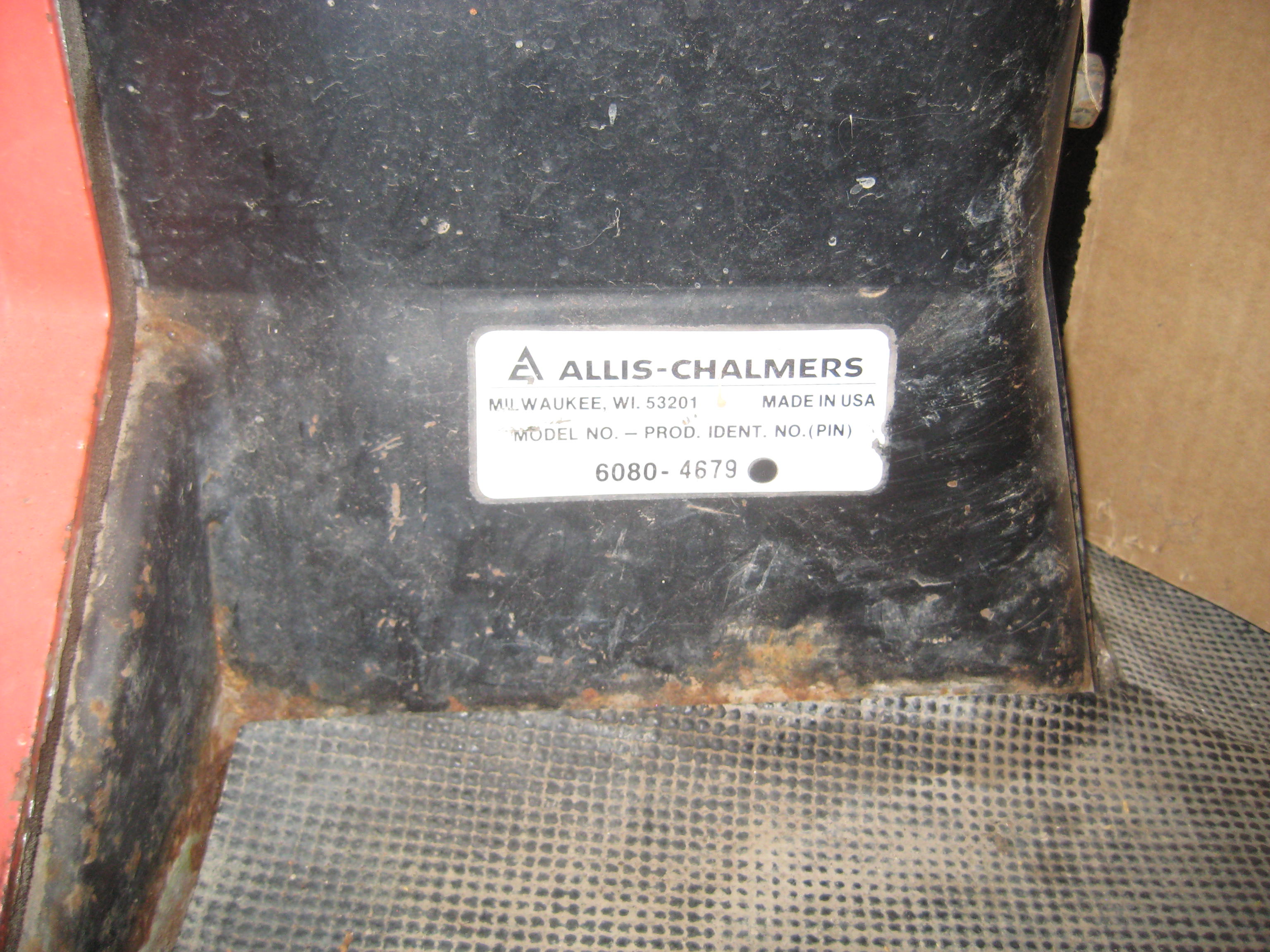

Trying to figure out the serial number so I can determine the year of the tractor.  Where I believe it is located is obscured by the loader and loader bracket.  I found this on the left side of the steering column near the floor of the cab.  Could this also represent the serial number?  If so, would appear to be a 1983 model year.

Yes, 4679 is the serial number.
