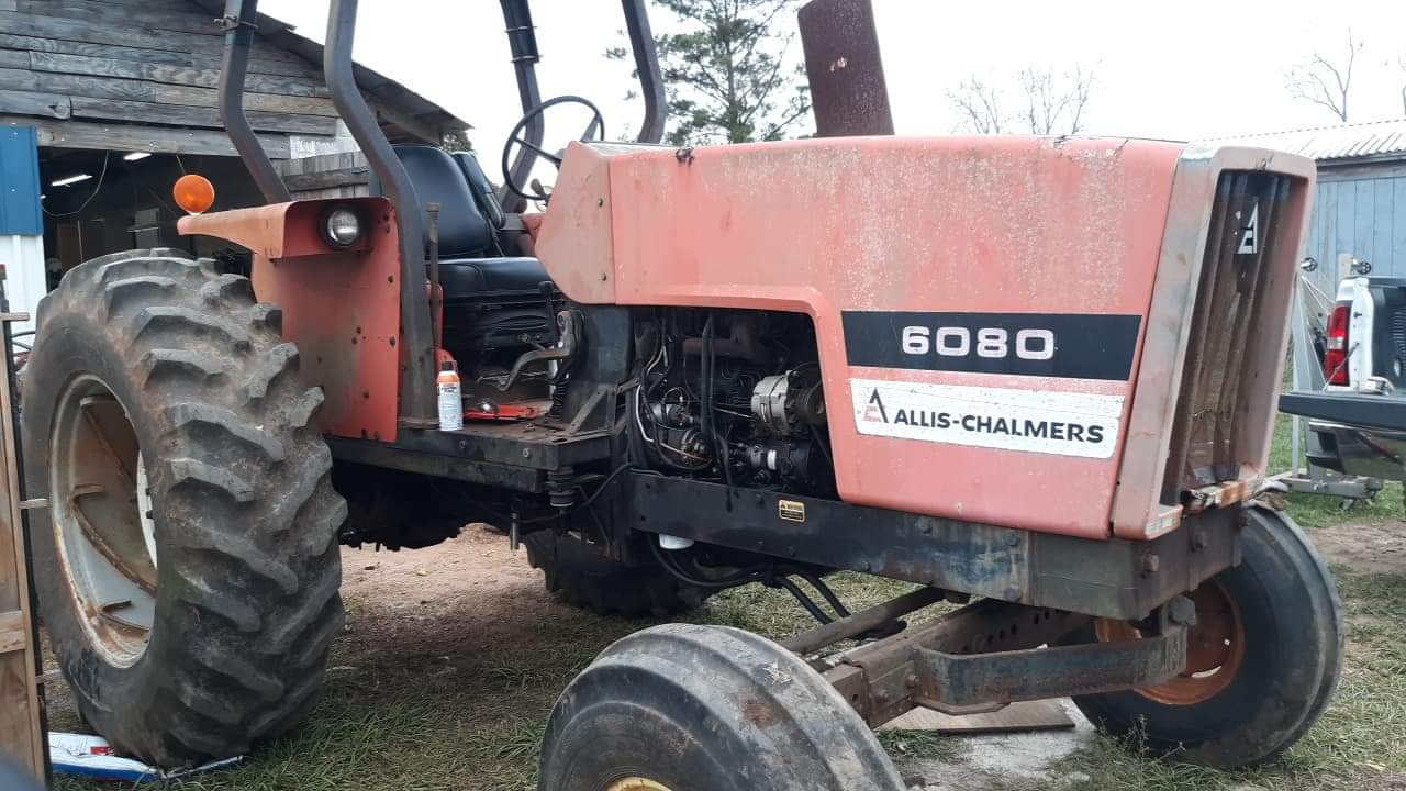

Hi everybody! I am new to the forum. I have recently undertaken the task of saving a early model 6080 for a friend. It hasn't been ran in roughly 15 years, it does now. The question I have is with the external thrust bearing. How is it shimmed or adjusted? Are there even replacement parts available? I have all the manuals(operators, service and parts) however, that is not even listed. The pto wont engage at all. The tractor runs and drives and brakes all work. Several weekends of fussing with it. But the bearing in the bra has me perplexed... thanks

Pics of tractor:
