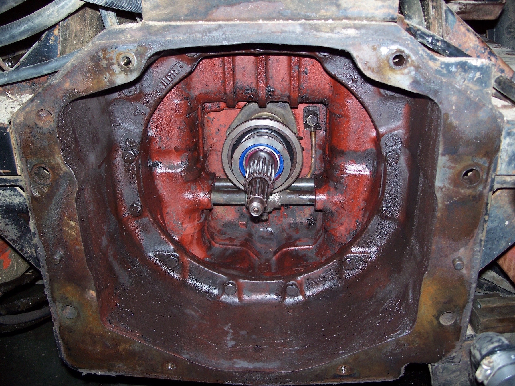

The clutch is pretty standard on these.  The release bearing pushes on clutch forks which release pressure on the disc.  My first thought would be a broken clutch cable, just make sure when you are pushing on the pedal have someone confirm the linkage is moving below.  This is what they look like inside.  Another thing that could happen , not very common though would be the bolt holding the release fork to the cross rod could have backed out or broken(you can just see the head of the bolt in the picture).  If that bolt was missing I think you could spin that shaft all the way around?  Or the last little bit of friction material could have just come apart on the disc.
Make sure you didn't bump the 3 speed gearbox in neutral when you were checking the clutch also?

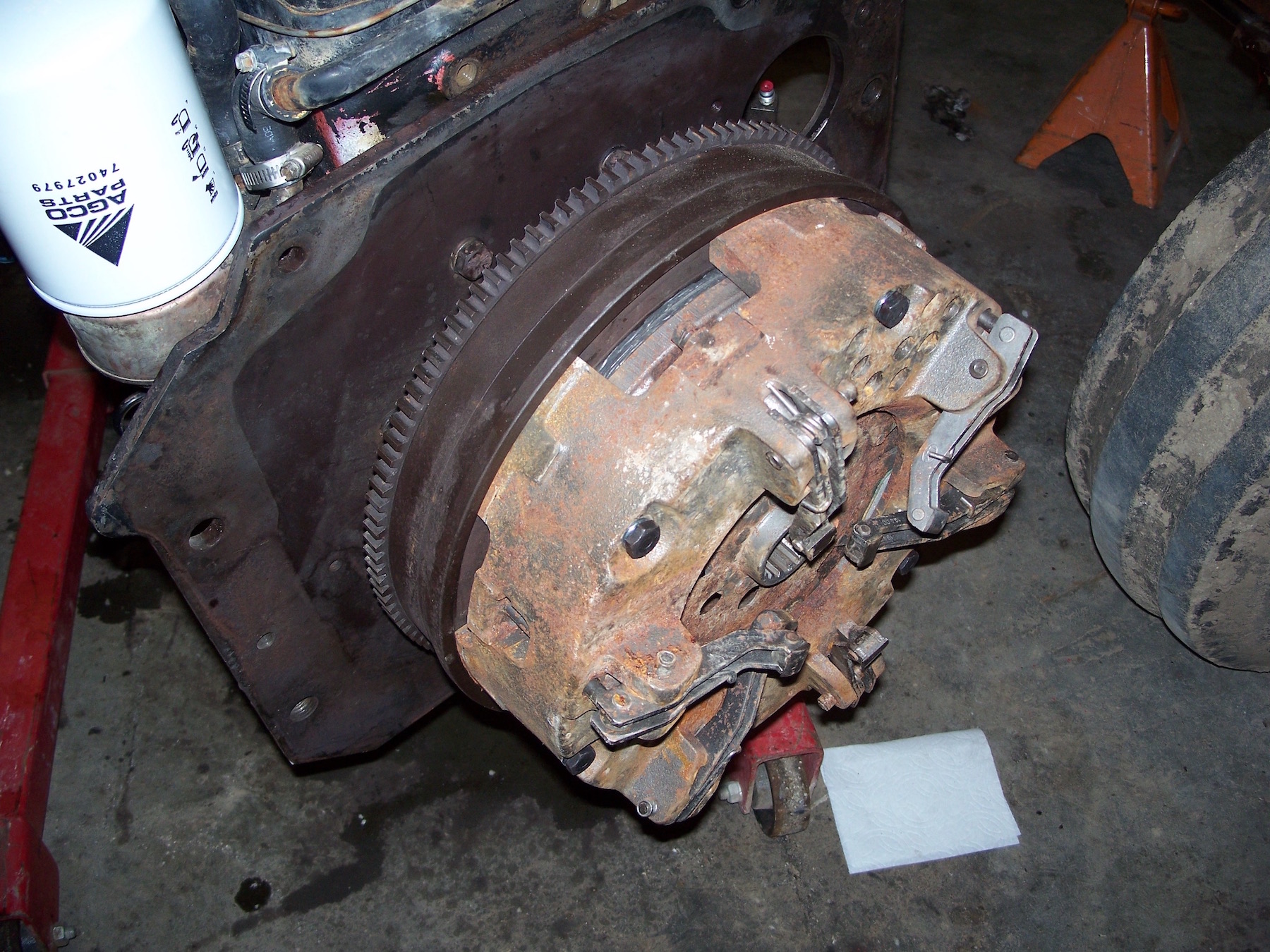

Here is what the pressure plate looks like.
It sounds like the clutch is not disengaging so at least you can move it to an area to work on.  Use first gear and low on the 3 speed, low rpm and it will just creep along.  Shut it off when you get where you need it.
