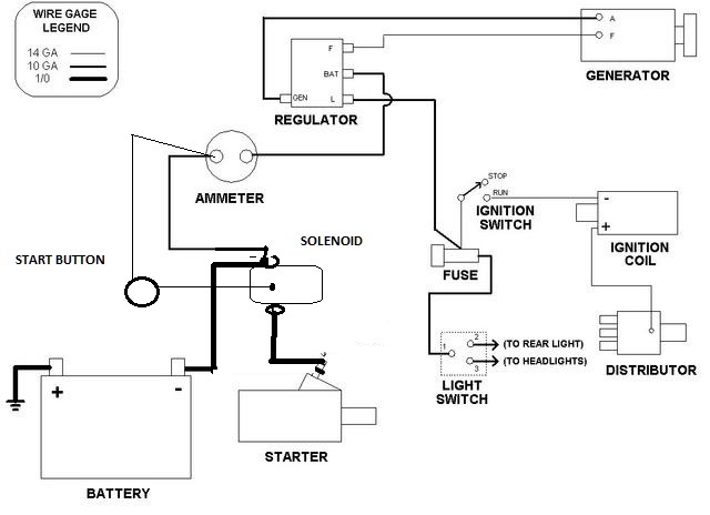

On a 6V system, you need a feed wire running off the minus (-) side of the Ammeter to the Starter button. From the other side of the Starter button, run it to the solenoids #10 post.  Should be good to go.
Steve@B&B

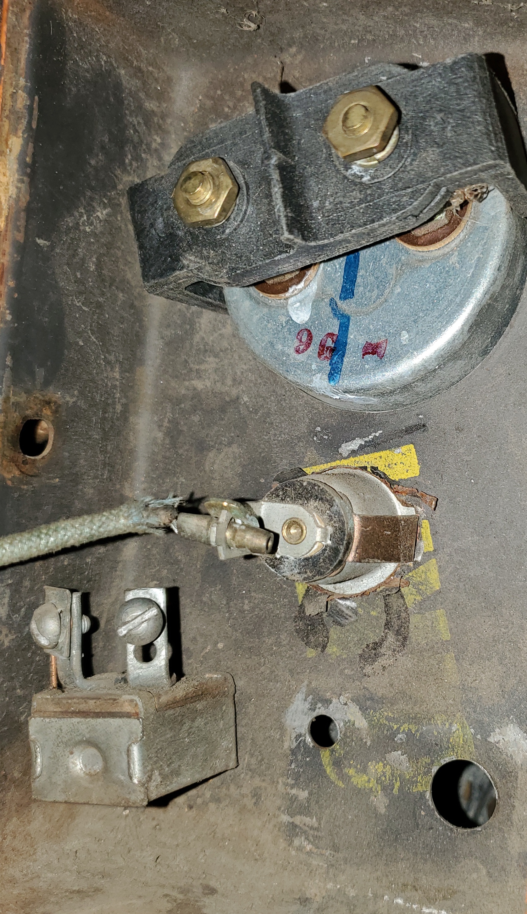

Steve,I understand what you described but think I will need to put a different starter button on the tractor. The current starter button only has one wire attachment. I've included a picture of what is currently there. Dan

Post Options Post Options   Thanks (0) Thanks(0)   Quote steve(ill) Quote  Post ReplyReply Direct Link To This Post Posted: 30 Sep 2023 at 4:50pm
YES.. you need a starter button with two wires.. One HOT from the ammeter and the other side runs to the solenoid........ solenoid should be bolted to metal as a ground.
Points: 90778
Post Options Post Options   Thanks (0) Thanks(0)   Quote steve(ill) Quote  Post ReplyReply Direct Link To This Post Posted: 30 Sep 2023 at 4:52pm
If you dont have an "L" terminal on the voltage regulator, then that wire that feeds the lights and ignition would come off the "B" terminal, or the other end on the ammeter.

Post Options Post Options   Thanks (0) Thanks(0)   Quote Jim.ME Quote  Post ReplyReply Direct Link To This Post Posted: 30 Sep 2023 at 5:37pm
With a one wire starter button, could someone have installed an insulated base solenoid on it that needs a ground, which the switch might supply when pushed, to engage the solenoid, like some Fords used?

Post Options Post Options   Thanks (0) Thanks(0)   Quote Alberta Phil Quote  Post ReplyReply Direct Link To This Post Posted: 01 Oct 2023 at 9:25am
That starter button shown is from a '40's Ford and just grounded the old 6 volt solenoid
terminal to complete the circuit and close the solenoid contacts to kick in the starter.
Alberta Phil View Drop Down
Location: Alberta, Canada
Points: 3980
Post Options Post Options   Thanks (0) Thanks(0)   Quote Alberta Phil Quote  Post ReplyReply Direct Link To This Post Posted: 01 Oct 2023 at 9:26am
terminal to complete the circuit and close the solenoid contacts to kick in the starter. I had many of those old Fords in my past!!

Post Options Post Options   Thanks (0) Thanks(0)   Quote Steve in NJ Quote  Post ReplyReply Direct Link To This Post Posted: 01 Oct 2023 at 9:39am
Phil, yer' showin' your age buddy!!  LOL!!  Do away with that old switch and pick yourself up a dual terminal push button and wire it like I mentioned and Steve's diagram.

DanCMN View Drop Down
Joined: 29 Sep 2023
Location: Dassel, MN
Points: 4
Post Options Post Options   Thanks (0) Thanks(0)   Quote DanCMN Quote  Post ReplyReply Direct Link To This Post Posted: 01 Oct 2023 at 2:32pm
Thanks for the insights on my current starter button and recommendation on what to do. I will be buying a new starter button. Dan
