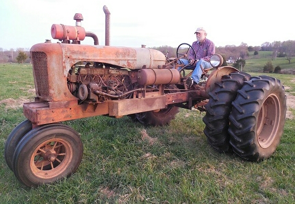

factory fit,looks like a ford 6 cylinder in this one.

Post Options Post Options   Thanks (0) Thanks(0)   Quote shameless dude Quote  Post ReplyReply Direct Link To This Post Posted: 15 Jul 2017 at 9:24pm
I have a 6 cyl Chevy motor in a WD, the fellow that did it did a wonderful job, almost looks factory. Joe you better gits here and pickup that tractor before the price goes up! lol
