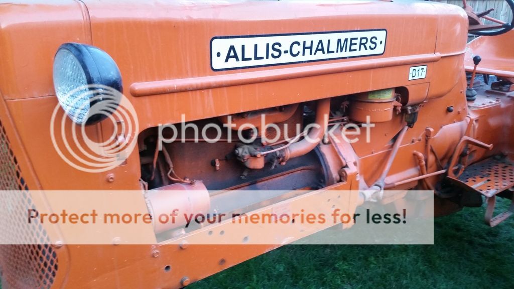

Pics to come but I just traded the WF for a pretty straight D17 Narrow front gas with power steering. Everything works pretty well except the draft control levers are stuck and the power director won't snap in to low the whole way and it whines. ..more so in high range. Runs and drives well. Ordering a manual today but can anyone five any ideas on the whining? Bearing? Thanks for any help.

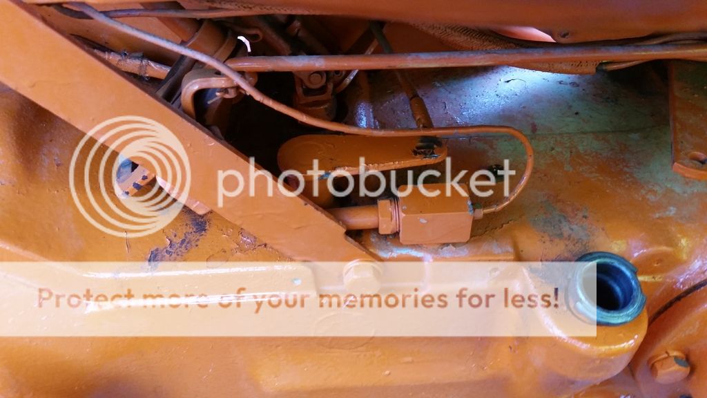

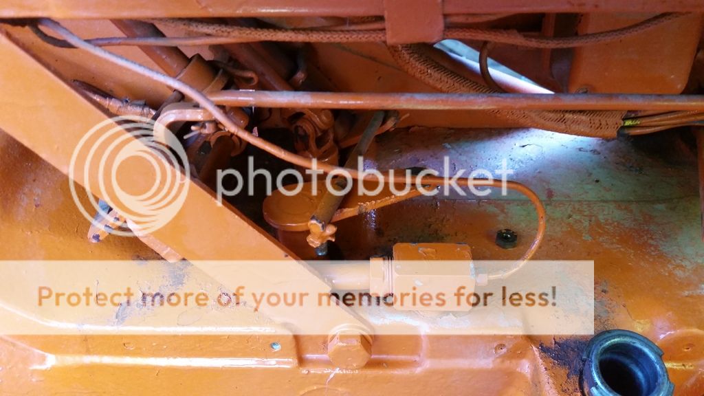

Under the gas tank there are a couple of pins that attach the linkage to the top of the torque tube. I would pull those pins and check that the levers are not binding in the linkage outside the torque tube first. You might get lucky and find a rust problem on the outside.   If it is internal I think you would ha e to drop the pump out and then I don't remember how good the access is. But it would be from the bottom or the motor side there is no access from the transmission side.
BennyLumpkin View Drop Down
Joined: 22 Mar 2010
Location: Centre Hall, PA
Points: 2657
Post Options Post Options   Thanks (0) Thanks(0)   Quote BennyLumpkin Quote  Post ReplyReply Direct Link To This Post Posted: 04 Aug 2015 at 6:48pm
So I unhooked the rod that goes from the lift handle rod to the part it moved into the pump housing. If the TB handle is in the down lost ion it won't move at all. Also the TB handle won't go clear down. If If I put the TB handle up I can move the other part a little. Even with some added leverage it won't move...doeas?
