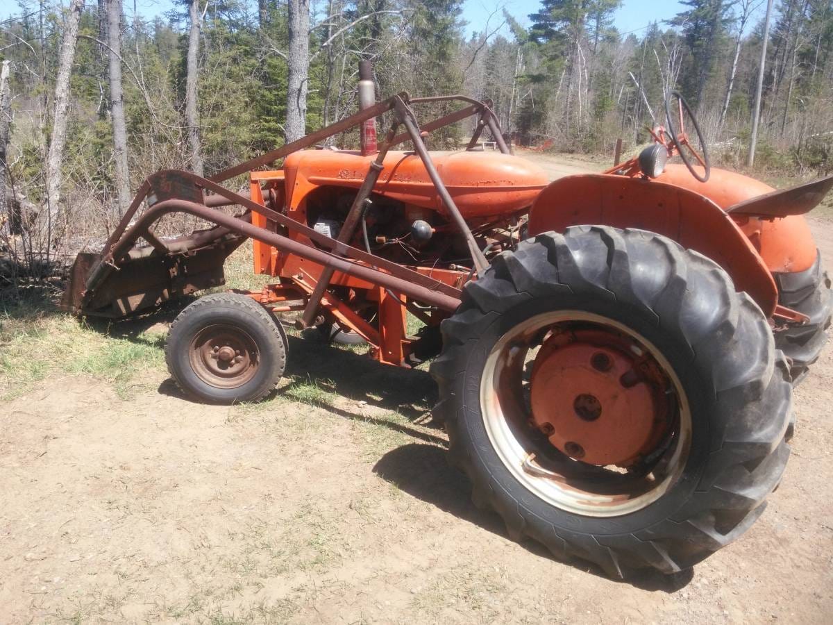

Heres a pic. Think I got a great deal. Picked it up for $2300 with the loader and a plow blade. Guy said it was resleeved 20 years prior to me buying it along with a new clutch. I would ordinarily scoff at that kind of statement but it was literally parked for 15 years and kind of forgotten about since his wife couldn`t drive it w/o power steering. He had a newer Ford they used and once the barn he stored this tractor in was needed for other things, he chose to sell it rather than store it outside. He was an older gentlemen and seemed believable. The thing runs awesome and already paid for itself by gettin 3 culverts ut in and about 30 yards of gravel moved and the pasture cleaned and 15 cords of wood pulled up front. LOVE it!
Just wonder why it took me till 47 years old to think....."I should get a tractor" lol Best money I ever spent.
