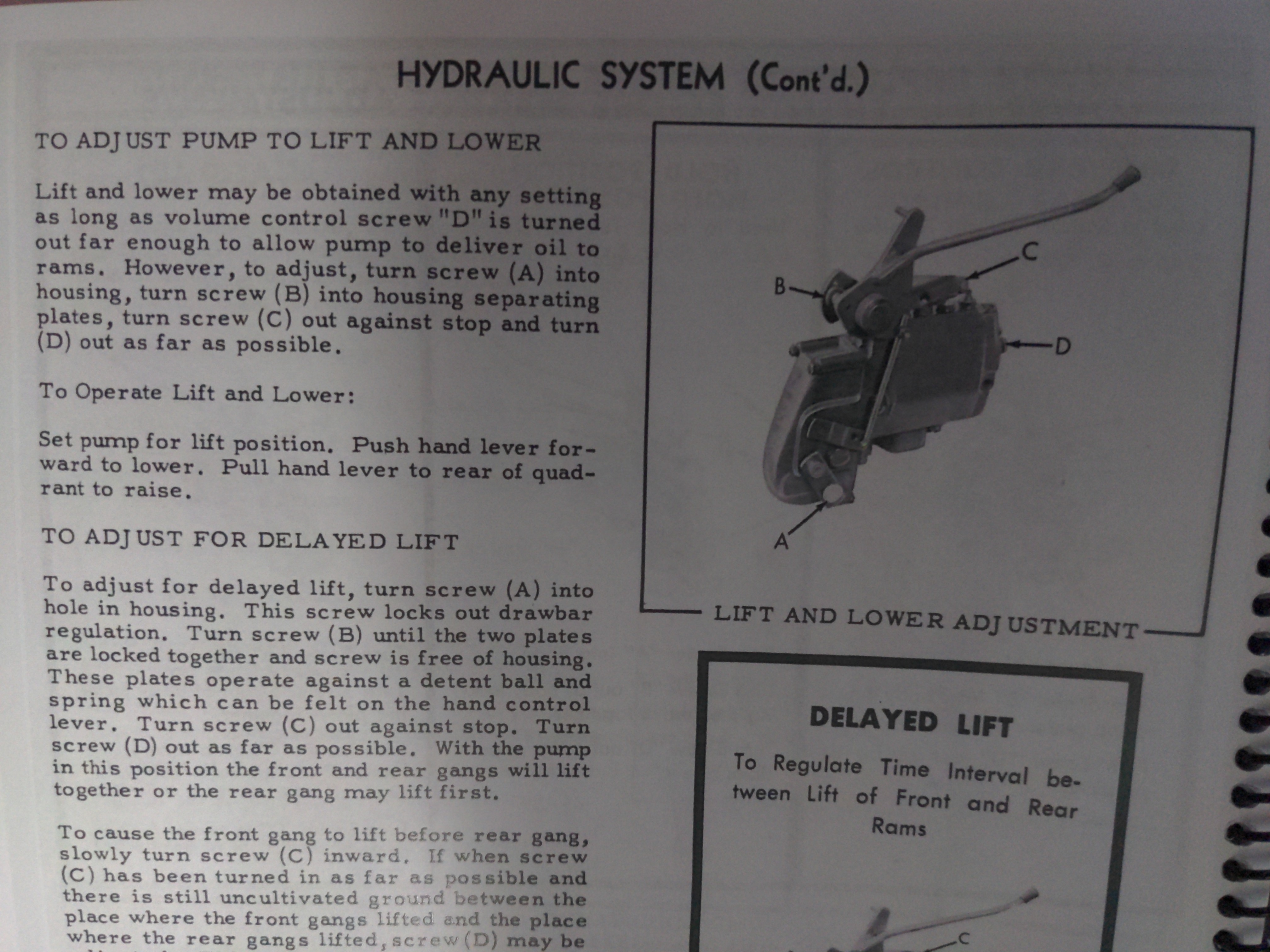

Brandon, i dont know much about the CA, but have worked on many B models ( different pump).. The description you have of  getting "more slop" in the handle and moving further, then stopping all together... i have seen on the external linkage with plates STUCK ( item 33- 35) , ball or spring broken or missing ( 36- 37) , etc..Sometimes just spraying penetrant on  33-35 could free things up... Cleaning out the oil is a good plan... But "change over a short period of time" could be some wear in the external linkage.. look at drawing below..... im assuming you dont have water froze in the valve body.

I went out today and they didn’t drift down still stuck up… with the converted snap coupler blade hanging. None of the linkage looked out of whack and nothing froze that I could see. It all externally looks as it did when it was working
Didn’t have enough time to do anything else, used the quad to do the drive today
I have it set in the hold mode, should I try switching to the other modes to see if it works that way?

Check under tractor to see if bunch of snow/ice is interfering with the traction booster, or lock out the traction boost with the knob

I don’t know a lot about the traction boost, just because it’s always worked, I’ll check it for ice tomorrow wasn’t bad when I parked it but I didn’t look close, but how do I lock it out with the knob???

Post Options Post Options   Thanks (0) Thanks(0)   Quote ACCA52 Quote  Post ReplyReply Direct Link To This Post Posted: 18 Jan 2022 at 10:43am

Ran it a bunch today and monkeyed with it…. I let it run a while to warm up the case, checked traction boost and un pinned it working it manually with pliers and it tried to raise. All linkages and all seem to be set right. I un pinned the plates and they weren’t froze and separated.
After a while running I could bump it up and it would creep down a few inches and slow, hydros work real fast up now. I pulled it into the heated garage and gonna let it sit overnight, I was able to monkey it and get it to drop after shutting it off but I was bumping the lever back and forth and I was in the almost up position… but the lever is real funky like something is stuck or froze inside, we will see what a night of warmth does.
After it froze up I drained and I refilled all the trans fluid today before running it so if it did have water it should have flushed some… could something be froze up in there? I was running standard universal trans fluid with a little Lucas hydro fix to slow the axle seal leaks and everything worked fine prior to the other day
Should I plan on taking apart the hold valve? Is that something that could have an issue…. Pump has good up pressure so I’m not sure what to get into next
