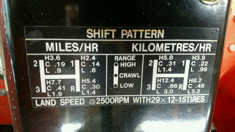

Looking to buy a 5015 with a belly mower and I wanted to know the transmission gear speeds anyone know what the speeds are thanks.

It can go slow, real slow, and really really slow.LoL
Tires can adjust the speeds a little.
It appears top speed is 7.7 mph and goes down to a snails pace.

Thanks looks like 2nd in high is the mowing speed

Yes 2nd in high at about 2500 RPM is what I run 2 different 4' bush hogs and a 5' finish mower if your grass isn't too heavy.
