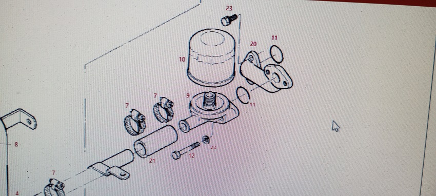

New here looking help.
I have a 5015 that I need to change transmission fluid on. I have read there is a screen that needs to be cleaned. Looked at parts catalog and can' find it. Where is it?

Remove oil filter housing to  the case , use a bore scope if u can't see straight in to see if it is a screen .
nonetheless ,still dead.

probley behind the  suction pipe  inside the trans were the pipe bolts on to the trans

The oil filter housing bolts to case , not the suction pipe .
 Remover filter mounting housing and # 20 ,   if you  believe there is a screen.

The 5020 and 5030 models have a suction screen that can be cleaned but the 5015 just has the spin on filter element. Agco part number 72100796.
