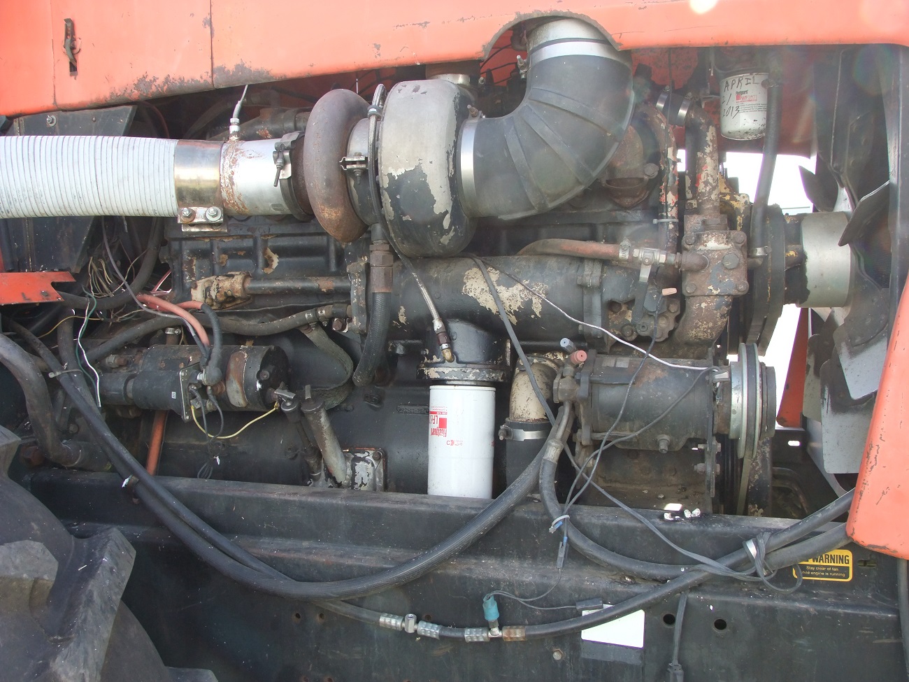

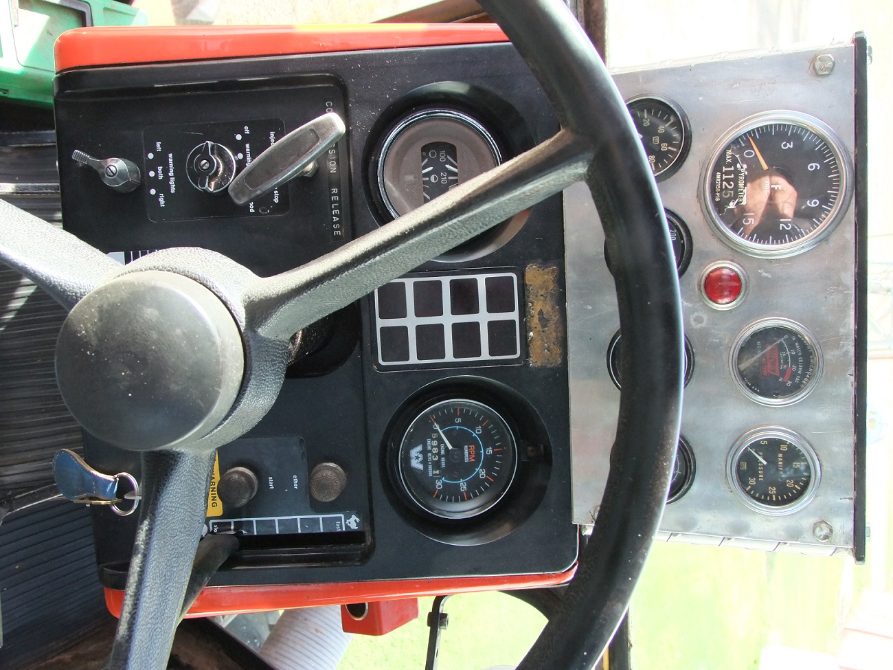

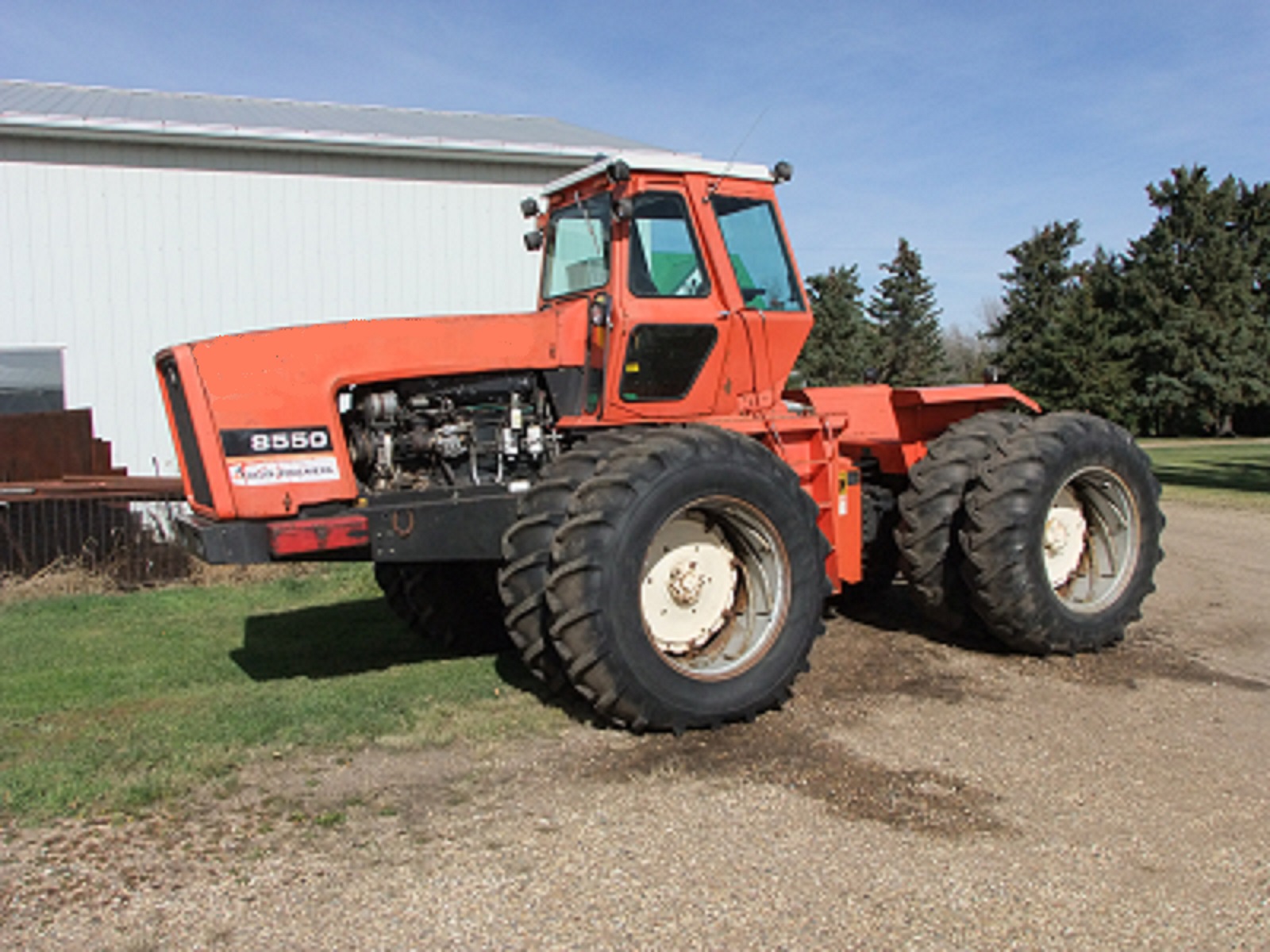

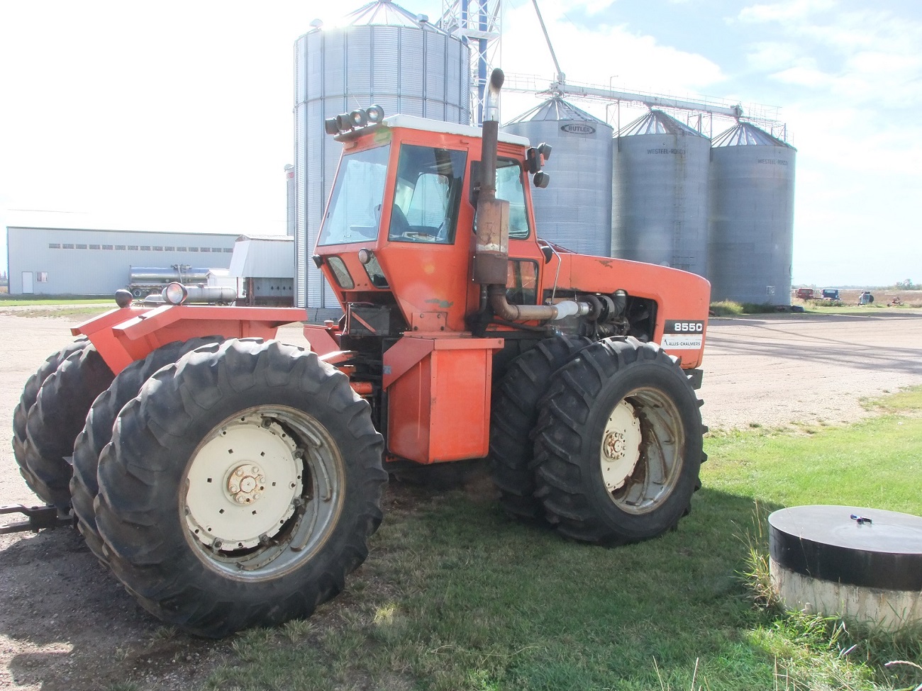

My 8550 siezed up a rod bearing back in 1989 and broke the block and all. Way back then AC wanted $1400 a hole for sleeves and pistons, $6,000 for a reground crank and $6,000 for a used block. It would have been $20,000 for parts and then add on labor. I decided to do a repower with a 855 ci 350 hp small cam Cummins and it made a really good tractor out of it. The rebuilt Cummins I bought for $10,000 with no core and had to build my own bell housing with the help of a machine shop. It took me all winter including rebuilding the main transmission, power director, and drop box and lots of little things. The fuel savings alone more than paid the cost of the repower in 2 or 3 thousand hours. The rebuild has about 4,000 hrs on it now and still runs perfectly. I am retiring so looking at selling the tractor. Not sure what to suggest but the parts are all there to swap engines. Cummins rebuild kits are readily available for $1200-1500 for all six holes. The rest of these tractors was really well built so upgrading to an engine that will always have parts available is a good move. I am currently in the middle of painting the whole tractor but will post a couple of pics from last fall. Call me if interested in buying or repowering. 780 662 2614
