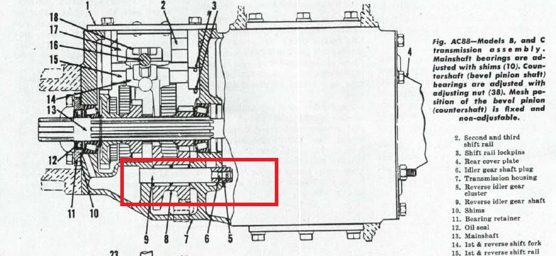

So to make a.long story short, I dropped the first/reverse idler shaft.
I managed to finagle it back into place by removing the side plate, PTO housing, seat frame etc, etc al.
I pushed up the front and using a brass drift from the back managed to cram it back where it belongs, sorta. It's too far forward, so I just put a couple fender washers in place of the lock plate and keeping my fingers crossed.
If Dr. Allis is around, someone let him know, maybe he can tell me what a time bomb this is.

never heard of that... did the plate come off, or what caused this ?
corbinstein View Drop Down
Joined: 31 Jul 2014
Points: 796
Post Options Post Options   Thanks (0) Thanks(0)   Quote corbinstein Quote  Post ReplyReply Direct Link To This Post Posted: 12 Jul 2023 at 5:05pm
I found the keeper that bolts on from the read busted an lying in the differential area, and the shaft was jammed into the ring gear spider.
